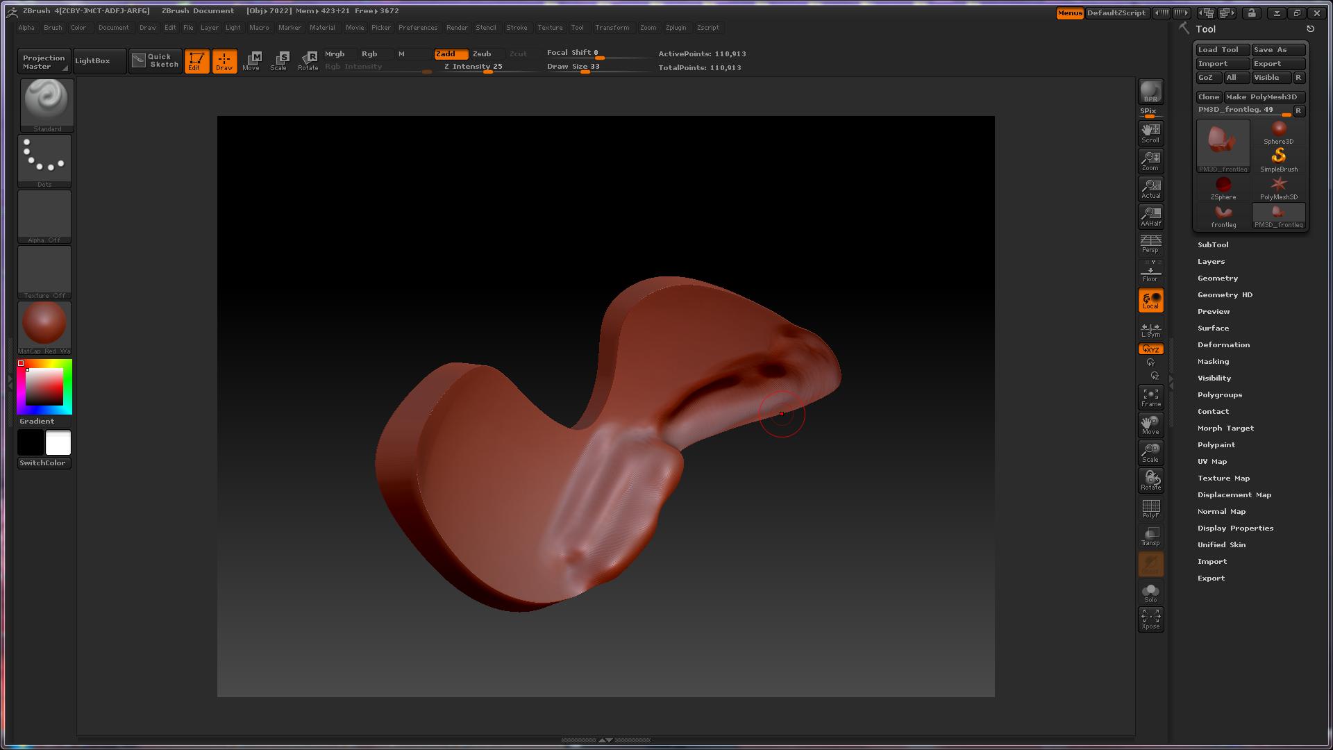

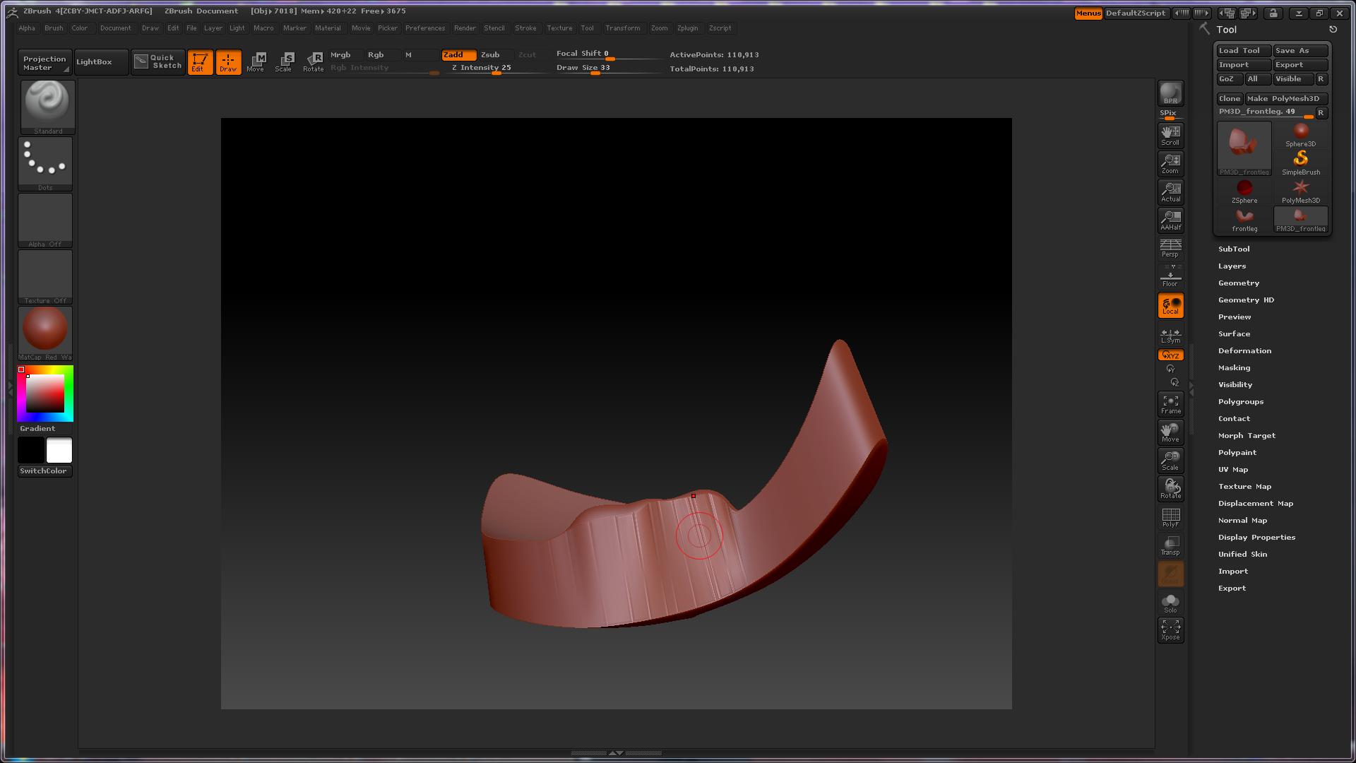

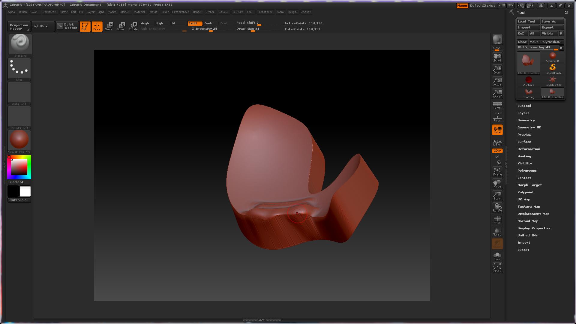

I imported this obj part made in Rhino. I can’t add or subtract material on the sides of this part? You will see that they are un-effected when I try to add/subtract or smooth them out. When I try to smooth them they take on a dark shattered look. I can work with the top surface and bottom but not the sides? Why? Anybody know why? It’s comming in at a 130000 polygon count.:slight_smile:

I suspect that if you turn on PolyFrame you’ll see straight lines connecting the two faces with no edge loops splitting those lines.
Sculpting moves points; not edges. If there are no points on the sides, then you won’t be able to sculpt the sides. You can add points by hiding the two faces and then using the Tool>Geometry>Edge Loop command (with Crisp turned off).
