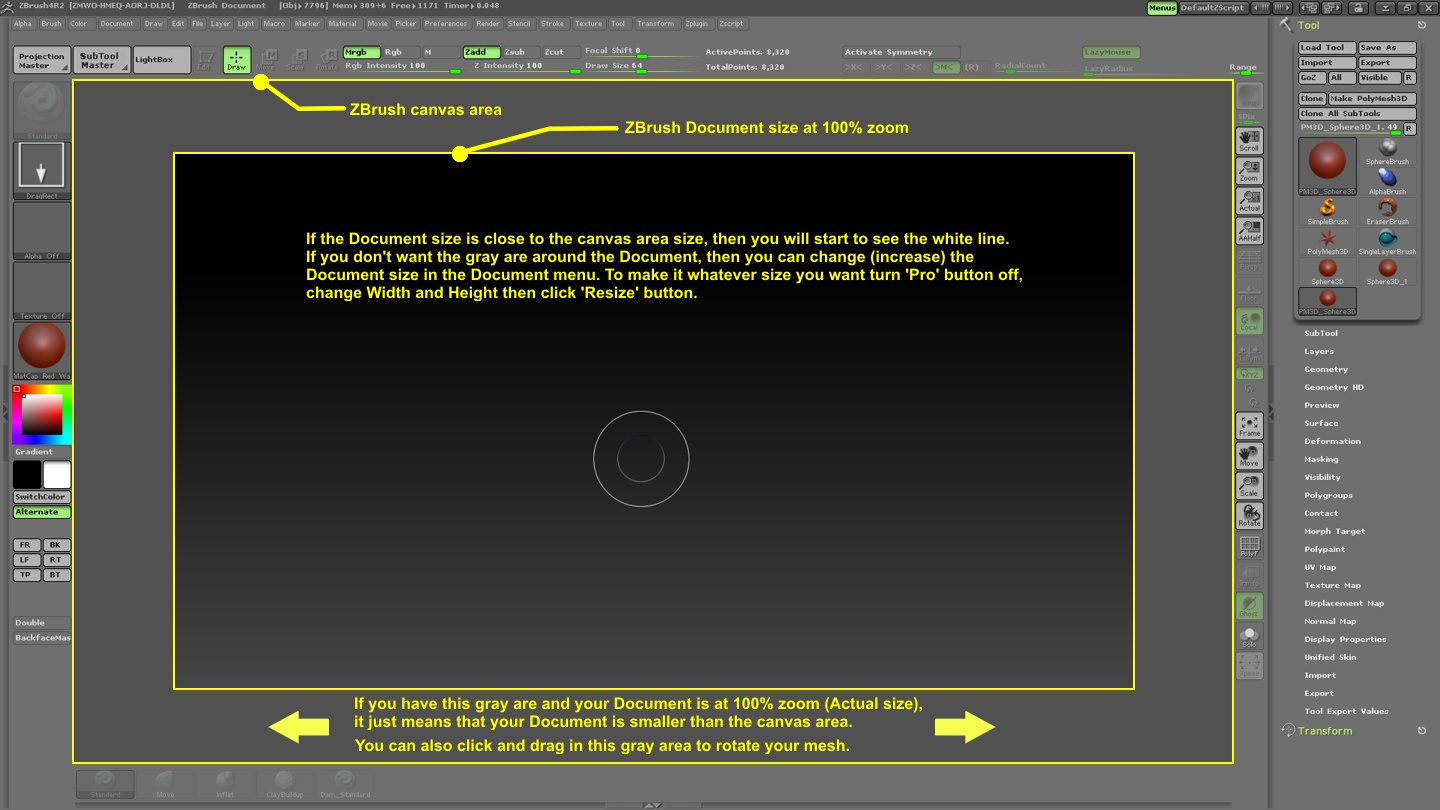

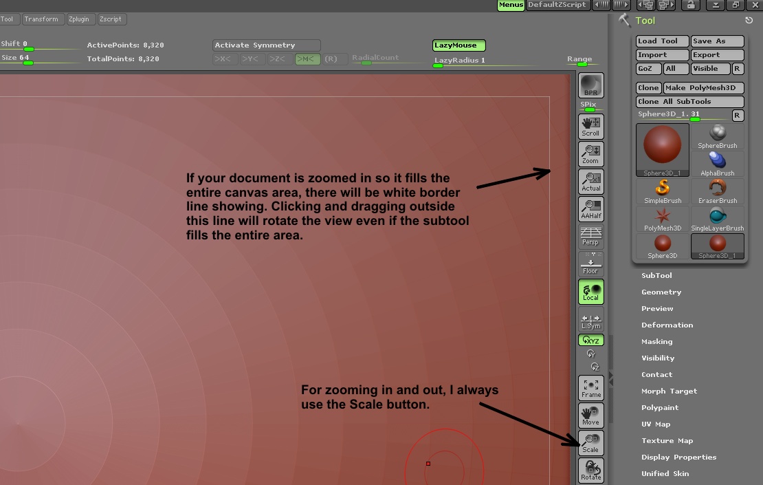

Don’t know about your first problem because Frame always worked for me. As to your other problem, see image below.

  2. ZBrush has two navigation methods. The standard ‘ZBrush’ way and the ‘Right-click’ way. You may find Right-click navigation works better for you:
  3. Right-click+drag to rotate.
  4. Ctrl+Right-click+drag to scale.
  5. Alt+Right-click+drag to pan.
For Right-click navigation to work you must have the Preferences>Interface>RightClick Navigation button enabled.

Thank you for the info. That is helpful. I had not noticed that white line before because my window has a big gray boarder around the image area. I think this gray area covers up the white line. I am not sure what this gray area is for. It seems like a waste of space. The gray boarder area may be responsible for my zoom problem too. Perhaps the F key zooms the object to fit in the whole window and then the edges are covered by the gray area.
