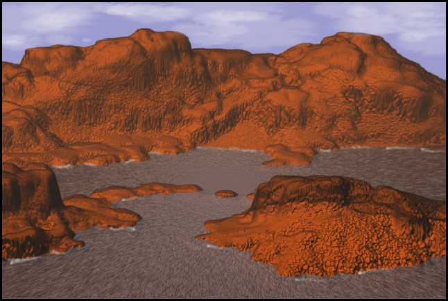

here is the 1st done in 2004:
[img]http://www2.zbrushcentral.com/uploaded_from_zbc/200401/user_image-1074273121ete.jpg[/img]
for some reason it looks different (and worse) three times: best in zbrush, then photoshop and then viewed with browser, so i hope what you get isnt too awful.
steps:
:small_orange_diamond: i created a doublesized standard canvas and sprayed a green and (almost) white texture (forgot to do it tileable).
:small_orange_diamond: i loaded a 3d-plane initialized to 16 by 16 to add very basic lowpoly mountains and valleys in edit-move-mode.
:small_orange_diamond: keeping the low poly planes approximate shape in mind i cleared the canvas and started to create an alpha with alpha brush using paintstrokes plus spraystrokes, making use of a customized alpha (nada special) for the latter and grabbed it (still doublestandard canvas)…
:small_orange_diamond: … then applied it to the lowpoly plane after dividing this about 5 times, then z-offsetting it the usual way.
:small_orange_diamond: i applied the greenwhite texture to the plane, rotated and fiddled with repeat h+v settings until i kind of liked what i saw, went into gyromode, rotated/sized the terrain into place and started snapshotting+placing copies into the background by moving the cursor downwards out of the gyro while in move or rotate mode.
:small_orange_diamond: on another layer i created another plane for the water with a gelshader and added ripples the deeveeway. at first i went for transparency so i increased the transparency and did a best render with flatten layers off.
:small_orange_diamond: i exported the result and loaded the flat image into a new document and following a tip given by Pixolator elsewhere (not his fault that the final result isnt looking that good - it looked very nice at one point but i spoiled it later on :)), i duplicated the layer and flipped it. with cloner-brush in layers mode at reduced rgb-settings and zadd-off i did reflections, followed by smudging and lots of postwork with 2d-brushes.
well, i hope you like it despite of the awful composition and that you might find one of the tips useful for projects of your own :slight_smile:

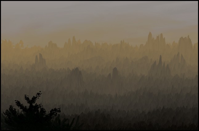

:smiley: as i never tried specialized terraining apps i know nothing about them (except that i adore the images done by those who mastered them) but i know its lotsof fun to terrain in z. here is a glacier, kindof:
steps taken to create this were similar to the last one. foreground thingies were done with zspheres, rotate+alt on link spheres to multiply mesh, cskin off, density 1 adaptive skin, textured with same texture as the terrain.
  • juandel

here is an edit of the last one part. for you… added 2d-painting in bg (with help of stencil to mask off horizon and a greyscale/low-rgb-move as explained here
hope you’ll like

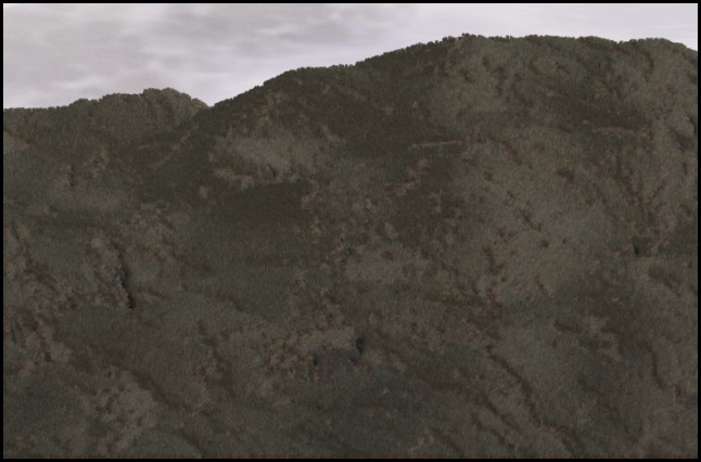

long time no see, amigos :slight_smile: here is my first try at Z2 alpha centuring - nothing special except using the fibershader for the first time and enjoying 2 gig ram (instead of 64 mb :D). it took me a while to find the commands i once knew by heart, but for me alpha century-ing seemed to be the easiest way to get back into pixolmode after many moons of no Z at all and to overcome that newbiefeeling :wink: i hope you will like
edit: 2nd Z2 - thanks for compliments, Pilou and Dave! :slight_smile:
[attach=2393]gebirge2c.jpg[/attach]
edit2: first try at Z2 water failed, but i got some new ideas for future attempts :wink:
[attach=2419]isolas1flatsm.jpg[/attach]
