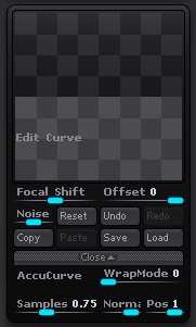

You need to edit the Fade-Off Curve in the Brush Menu. Set both points on the curve to V=5. Leave all other values at their default settings. This gives you a perfectly horizontal Fade-Off Curve and will give you an even thickness corner to corner when you drag your alpha on the mesh.
you can also set your focal shift to -100 to achieve the same effect. (well, depending on the brush)
