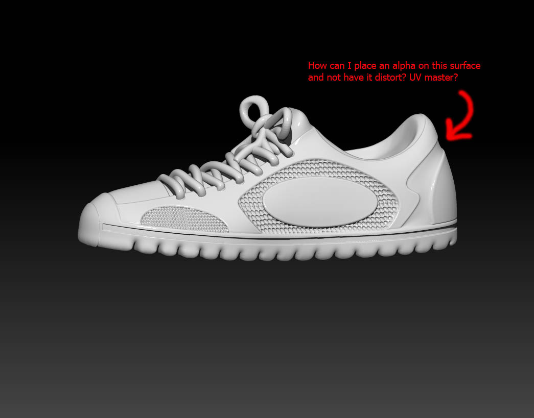

Can anyone tell me how to use an alpha on a curved surface and not have it distort… Projection master doesnt do a great job on curved sutfaces…

Projection Master works better for curved surfaces when you have them UV’d and morphed before using it. It’s an older method though, and has since been made faster / simpler by Surface Noise (use UV Master first if you don’t have UVs). You can load your alpha there, have it set to use the UVs, and use a mask to isolate which areas of the mesh it will wrap around.

Can you give me a quick break down on how to wrap an alpha around a curved surface once the model has applied uv’s…
