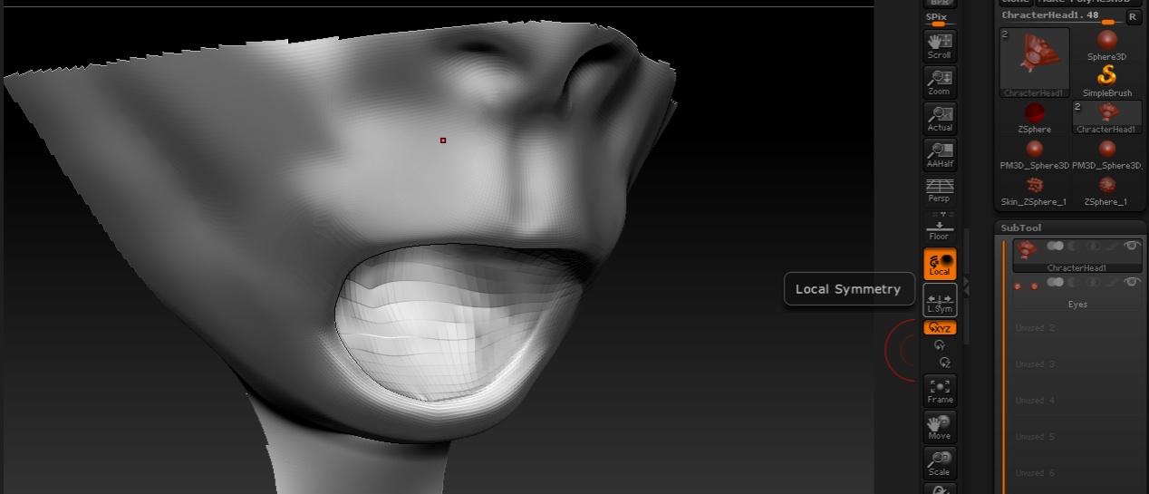

I need some advice on how to create teeth and gums for my character.
See the attached image: You can see I have sculpted my character with its mouth open and want to add teeth. What approach should I take to creating the teeth: Should I go into Maya and build some basic teeth shapes the bring them into zBrush. Or Should I add another subtool to the model ? This seems like the obvious approach but I have no idea what method I need to sculpt the teeth as a sub tool . Can someone please give me some advice or point me to a tutorial that shows how someone does it.
There are many ways of doing this. I usually use zSpheres for teeth. You can create gums of almost anything, sphere, zSpheres, Plane, cube… you name it. A little retopo might be required, but that’s ok :slight_smile:

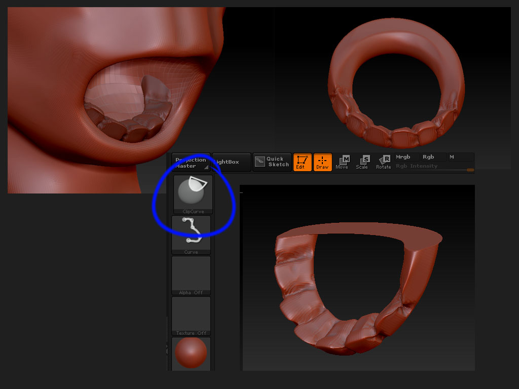

This is how I did it, I created teeth using a torus shape I positioned it into the mouth and then started sculpting.
How can I delete the back half of the torus shape ? I tried using the “ClipCurve” brush but as you can see from my attached image the “clip curve” brush does some sort of strange Boolean.
Can someone suggest how I can delete the back half of my Torus shape.
Looks like I am answering my own questions tonight.
So to delete Geometry I need to mask and hide that masked area then click on Geometry/Delete Hidden. :slight_smile:
