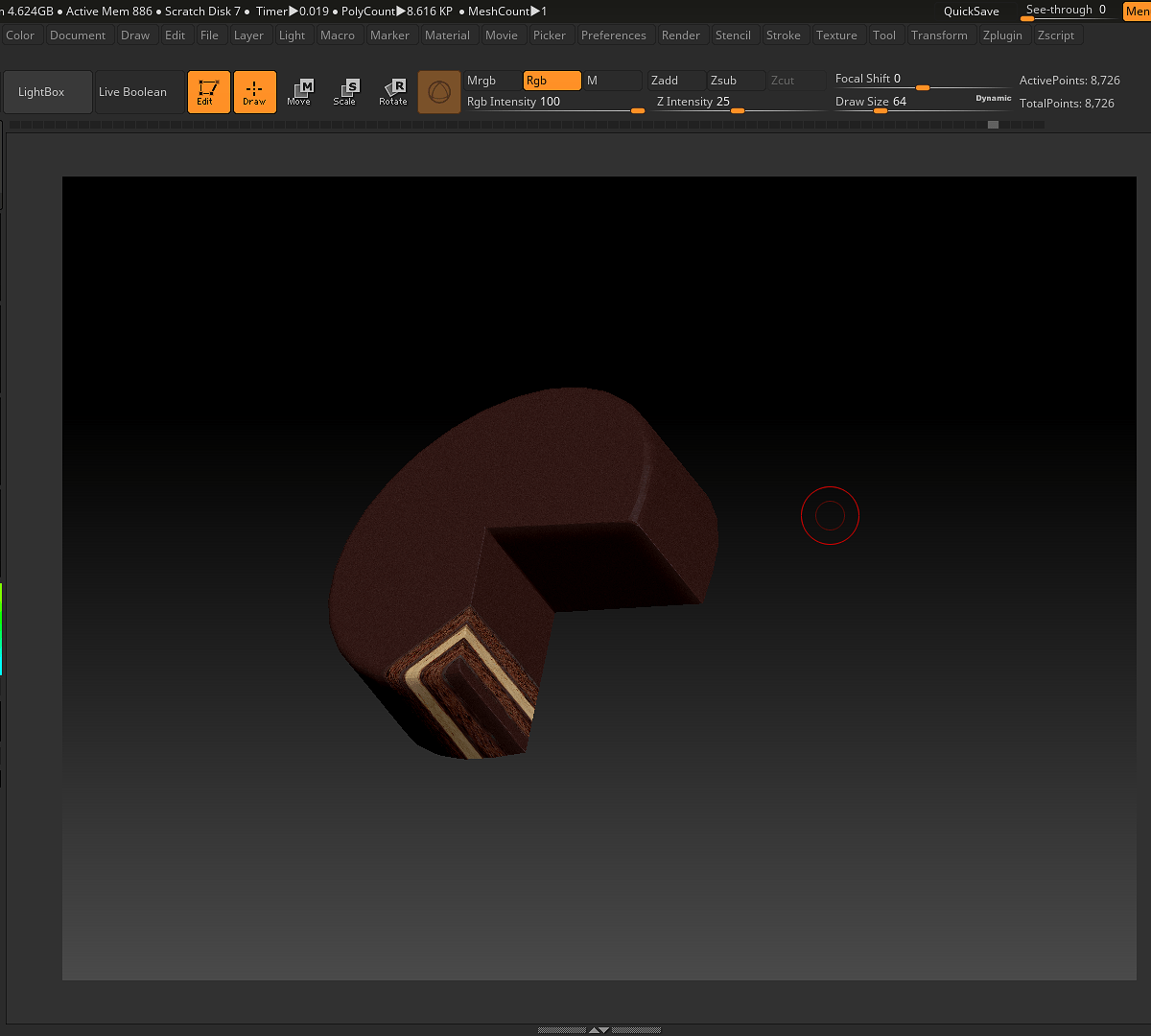

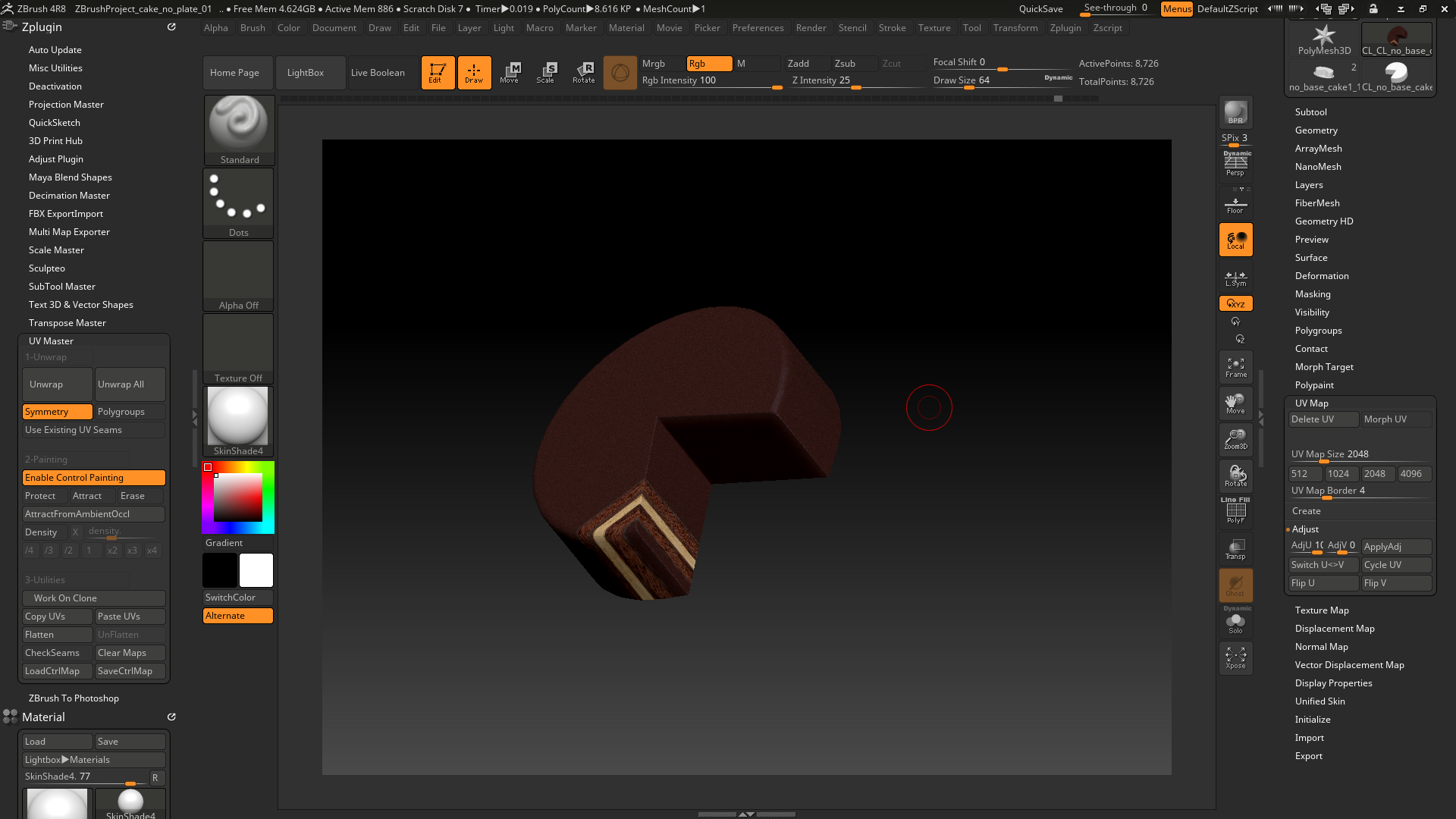

Hi, i know it has been awhile in this thread but i was wondering if someone can help me as well-
I use the 4r8 version and i happen to encounter a problem- i’ve imported a model inside zbrush and its’ texture as well and than after using the protect and attract colors and unwrapping it the texture got all messed up . i’ve tried to adjust it with tool>uvmap>adjust but it takes lot of time and it’s not really accurate…does anyone has any idea how do it better? would really appreciate any thought on the matter…
