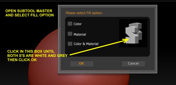

My apologies, the other was for resetting material only. The following should work.
Yes! Thanks a ton. But now I’m curious what happens when the S’s are multicolored with the gradient?
Clicking that box toggles polypainting on and off for all visible subtools and deselects color and materials.
