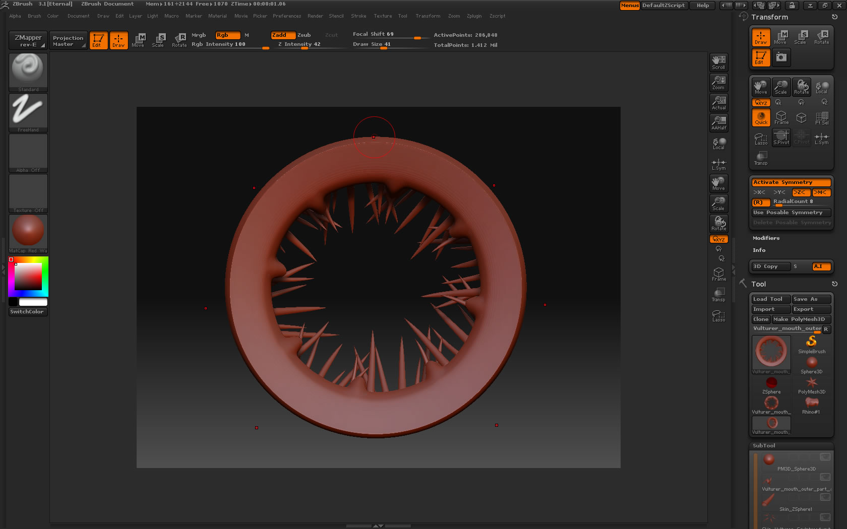

Hy all!
I have a question for you, and I apologize if identical or similar thread already exists, but this is an urgent matter to me.
I noticed my radial symmetry is a bit off. Here, allow me to show you this screen shot, does anyone has a solution?
Be well!
[ATT=]activated_radial_symmetry_offset.jpg[/ATT]
It appears that your model isn’t centered. Either press Tool>Deformation>Unify or click Transform>S.Pivot. Either will have the effect of centering the visible geometry so that symmetry works correctly.
The deformation is a permanent change. Setting the pivot can later be turned off by pressing C.Pivot.
Thank you for your help :wink:
