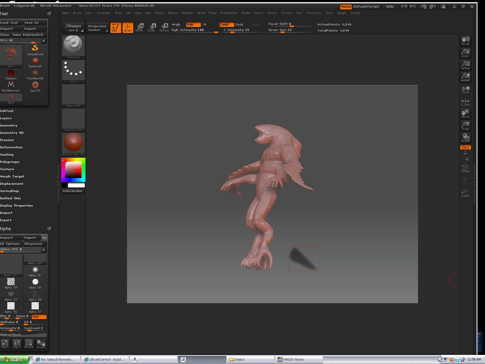

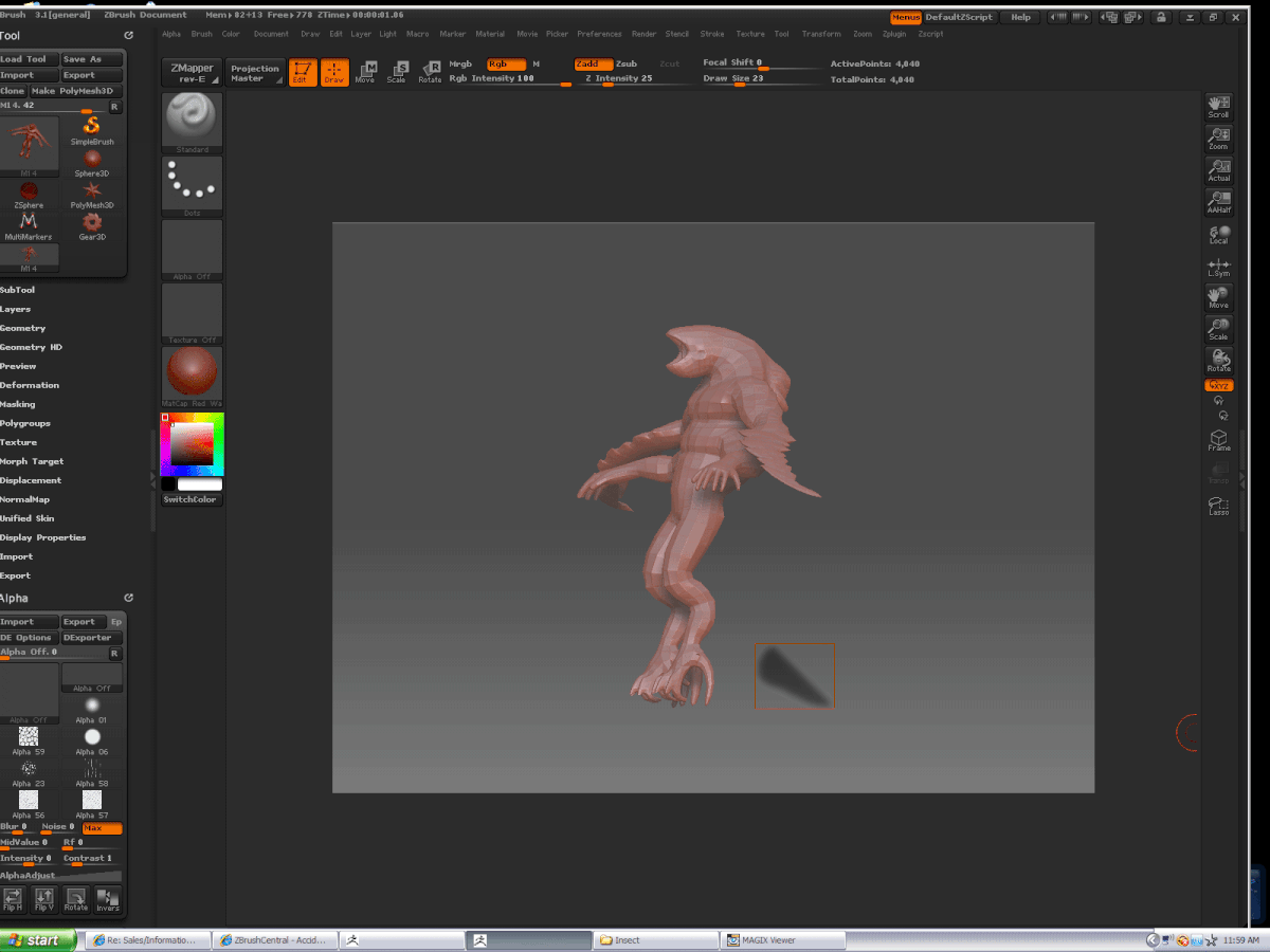

It happened while using the lasso tool to create a mask (see screenshot)
How can I undo this type of mask? Thank you for your help.
its a stencil, in version 3 they decided it was a good idea to add this to a key combo similar to hiding, which obviously you are getting wrong(as do i when working fast), either way to turn it off when it happens just turn it off in the stencil menu.
