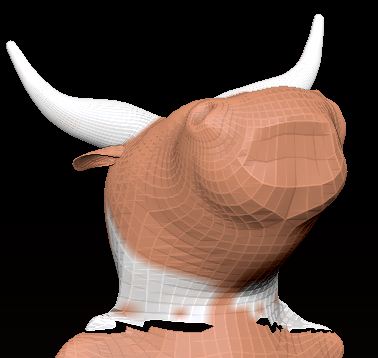

To reassemble the two subtools, I used Merge Down. (Merge Visible was grayed-out.) It did merge the two subtools; however, they merged imperfectly. (See .jpg.) In addition to the gap, notice that the polypaint from the horns is now applied to the body. Is the fact that the model was polypainted a possible complicating factor?
Groups Split was greyed out because you didn’t unhide the hidden portion. Everything has to be visible for Groups Split to work. I didn’t mention that in the other post, I know. I guess I should have. Sorry.
I also should have metioned that if you are going to be making Polygroups, that you should do them in the lowest subdivision level.
If you are going to divide your model, you should not do it as a temporary thing and think that you can easily join them back together later, because once you divide and start doing more work on it, then it’s not going to fit back together. In fact, the only way to put it back together would be to fix the topolgy or to retopolgize the whole thing. Especially when one part has a higher subdivision level than the other. In your case, you would leave the head and body as seperate subtools and use something to hide the seam between the head and the body like a collar around the neck for example.
