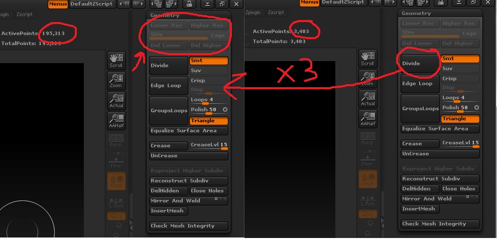

Certainly.
I export the mesh from Maya -> Import in Zbrush -> Trying to Subdivide with settings like in the picture.
Thanks for the reply.
Hey dude, from the screen on the left it looks like you haven’t gone into edit mode after you’ve drawn your tool on the canvas. You do it by pressing ‘T’ on your keyboard or hitting the edit button at the top, which is placed between the projection master and draw buttons., after you draw your tool on the canvas When your tool is ready to be edited the brush cursor turns from gray to red.
Hope it helps.
