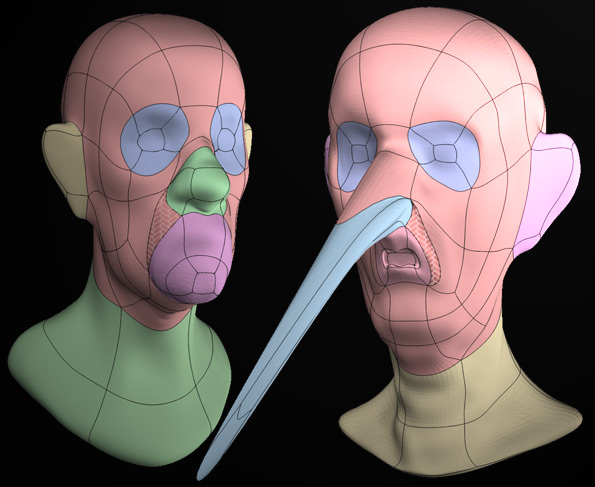

OK, now I have Nos, the way I like him. :wink:
Now to put them together for the Halloween thread and my ecard.

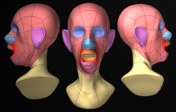

heh-heh-he… such great fangs.
Hi Jason, this has been a favorite thread recently.
I’ve tried copying your last zsphere setup, can’t seem to get the geometry identical.
Maybe after the holiday you can do a quick and specific tut?
Me wanna play too.
How many polys is he at the lowest level, and at the highest level btw?
Hello joe_seig, glad your enjoying this.
At level 1 he is 96, and at level 6 he is 96258 zspheres/polys.

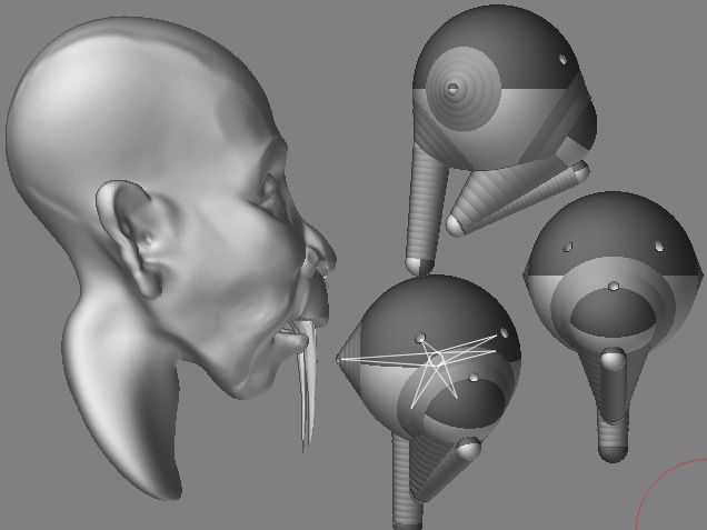

Here is a clearere look at to what has ended up a great setup for zspheres. The difference between earlier setups is the extra zspheres to provide the chin/lower jaw for those who want a little more control over posing.
If it’s still not clear, just holler. :wink:
Note: Ires 5, Mbr 2, Mc on, that should so it.

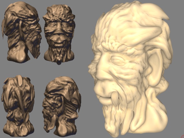

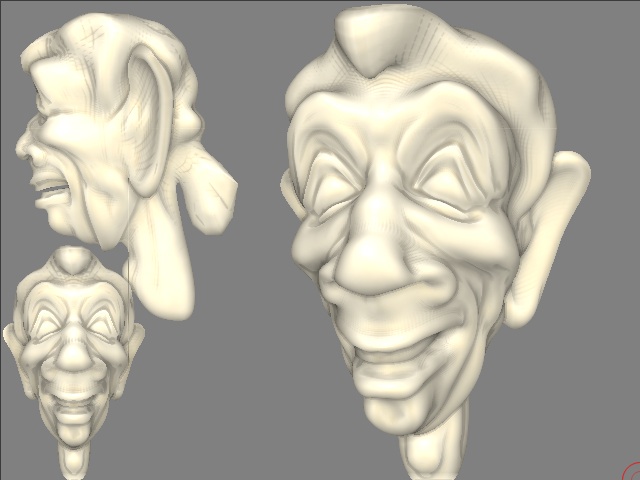

I’ve posted this on the Halloween 2005 thread, but decided to add it here as it shows all the boys together. :wink:
Great collection Jason, all from the one posable zsphere structure, nice work.
I decided to try your set-up this morning, here’s the result.
[attach=24303]Joe_Seig_LowRezSetup.jpg[/attach]
Following your settings, (put in before drawing the initial zsphere) I arrived at 94 polys for the base (you have 96).
At level 6 I’m showing 94,722 (you have 96,258)…
Are you using TVeyes’ xyz script somewhere?
Notice the 3-sided polys marked at the mouth, I’m not seeing this geometry in your images.
Super lightweight setup you’ve made, tried rotating the bottom neck sphere, works great.
Thanks in advance for any advice.

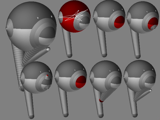

joe_seig, my humblest apologies. Let me re-state.
The main zsphere off the face representing the mouth area has a small zsphere inset into it at the top, one at the front as well (inset), then the bottom one extends down below the chin and the last extends up again. So you need the master head that the ears and neck and eyes are attached to as well as the master face. To the master face you add the little nose, little mouth and lower jaw which consisits of 2 zspheres. And, the master face does have xyz script applied to it at 1 1 1 - just that zsphere.
My apologies, I just remade it again to be sure of the step I missed in my earlier explanation. I hope this rectifies the issue.

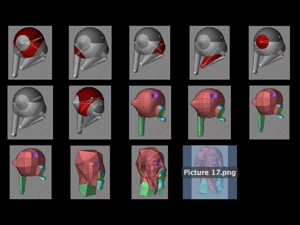

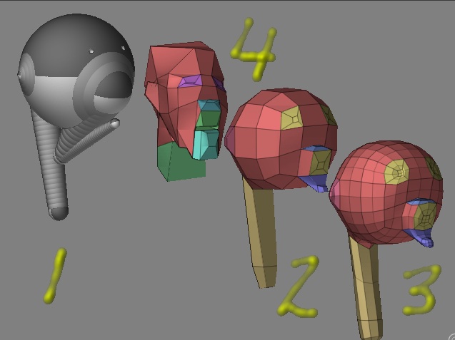

In the mean time, here is a little more detial, to our terror stricken friend… :wink:
