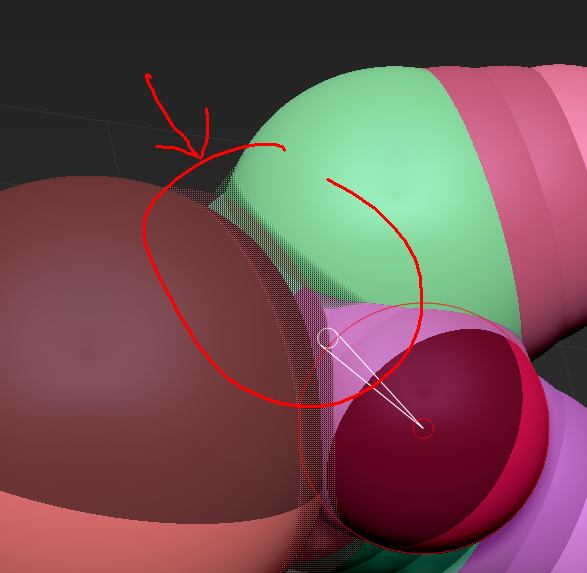

When creating a ZSphere model, if you see a dotted area as shown in the image then that indicates that the resulting Adaptive Skin will not be ‘clean’ at that point and it is best to move the ZSpheres further apart. However, meshes created from such an arrangement should not crash ZBrush.
I’ve sometimes experienced crashes when using zspheres; they did seem to be due to badly placed spheres as marcus suggests. When new to using them, I also inadvertently had tiny spheres inside the rig without realising - sometimes it crashed and sometimes not - but since I’ve become more aware of placement I’ve had no trouble.
