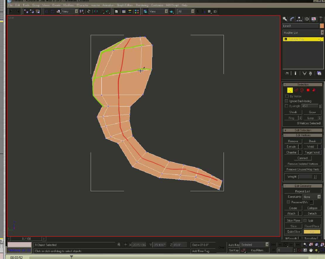

. im following a gnomon creature modeling tutorial and im stuck on the part where the artist is making the vertical lines across the horizontal lines on a mesh. im posting a pic on the part where im stuck on the video because i cant really explain.
in the picture the green lines represent a vertex i can make and the red one is a vertex i cant make. i dont know if you have to press a key on one of the horizontal lines to connect so i can go to the next horizontal line . i hope some one can understand what im talking about and help!!
Go into edge mode, selec a parrallel edge to the others that you intend to cut across, press ‘ring’, then ‘connect’. This will connect all the edges along the ring.
If you want to go one edge at a time, go to poly mode, and use ‘cut’ instead.
That what you were looking for?
