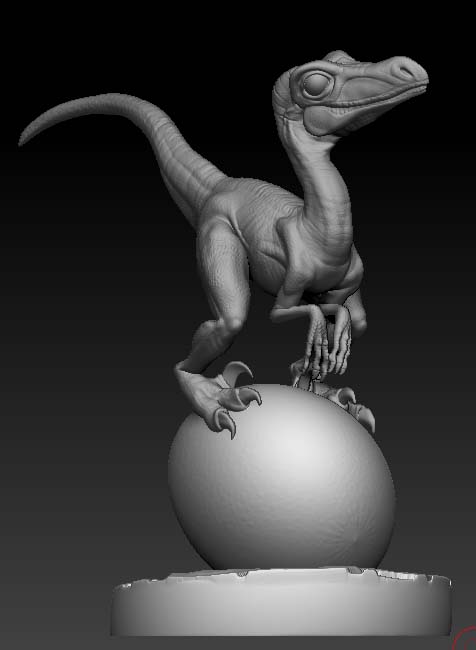

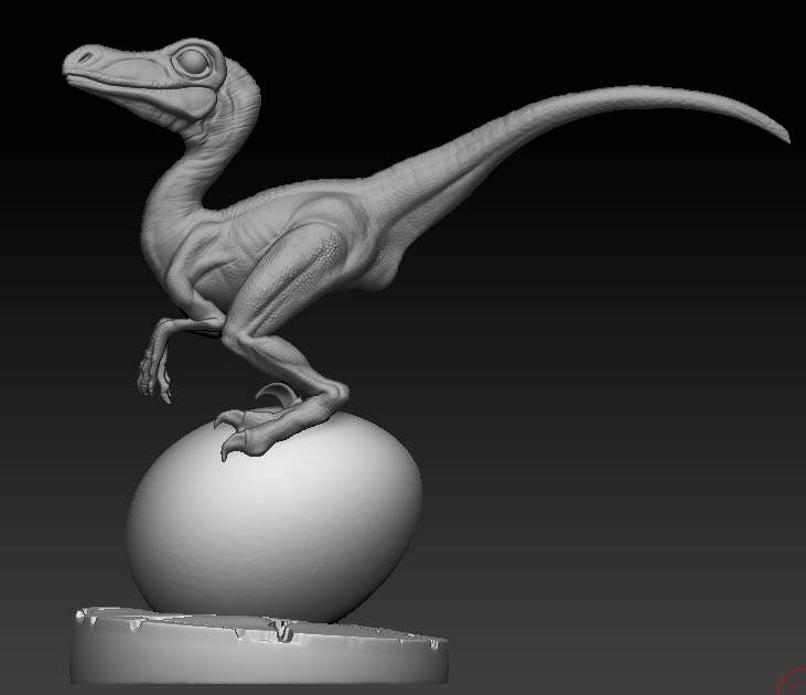

I had some questions regarding the process for 3D printing of this sculpt.
It’s already been decimated and is currently at 534,618 polys. I made sure the geometry is closed and that all the parts are overlapping. They are now combined into one piece and I converted the geometry to a .stl file. I am wanting to output at about 10 inches high–but I could probably go smaller. All the parts look sturdy enough and the base looks good.
So my question is, do I need to do anything else?? I have seen sculpts where artists have broken up the sculpt using bolean in another 3D software (I use Lightwave) however, Lightwave crashes every time I try to open the decimated file. So, I don’t know whether that’s an option–or is it even necessary??
I have watched the tuts by Jeff Feligno but wonder whether I am missing anything. Any help or guidance would be appreciated. Thanks so much y’all.
Cheers,
James

Oh crap, got so caught up in trying to get you info on 3D printing that I forgot to compliment you on a fine sculpt. I like the balance you have going on, from the base to the egg to the cool little dinosaur. Amazing sculpting skills you have my friend, refined-:+1:
Ha! No worries. Thanks for the wealth of info–and the kind compliments. I have been working at this Zbrush thing for just a few months and while the learning curve is indeed steep, it is SO much fun. So many possibilities. Anyway, I have a few requests for quotes out there and hopefully I’ll hear something soon. We’ll see–and yes, it ain’t cheap. But I think the price will be coming down soon. I hope so anyway. I am hoping to get a few things made but I want to see that it is worth it, you know? Anyway, again, I thank you for your help. I will certainly let you know what I hear. PM me if I forget. Stay tuned!
