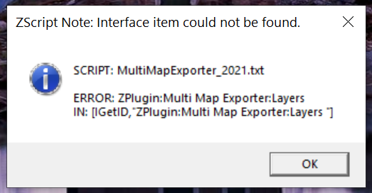

I updated zbrush with the updater and I get this error every time I launch the program. We use this plugin a lot, so it’s pretty important that it works. How do I fix it?
Hi @Zo_Nanoko
Did you use “updater.exe” or “ZUpgrader.exe”? You are supposed to use ZUpgrader.exe. You might have to download and install the full installer now.
oh boy… I’m 75% sure I used upgrader since that’s what I normally do, but I’ll just try the whole re-install thing anyway.
As Zber2 says, a clean install is probably the best thing to do. I think you probably have two versions of the plugin installed, causing a conflict.
-Marcus
Yup… that did the trick, and I didn’t even need the backup of my brushes and UI (which I was certain would all disappear with an un-install) Thanks for all your help!
