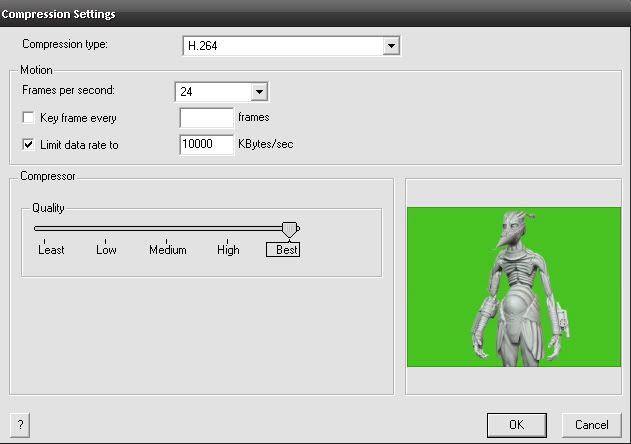

here are my export settings…
I notice that if I create a movie using preview render mode that the movie will export ok, but if i try to use best render mode it just gives me the grey screen
