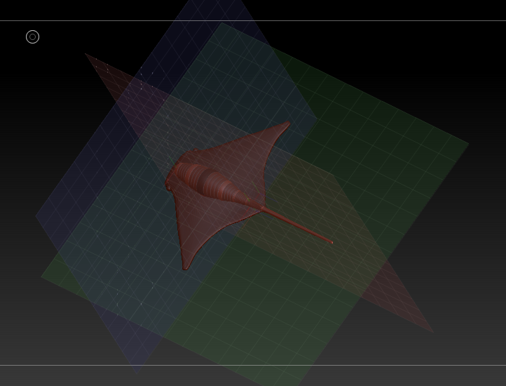

I thing that I was observing was an effect of what Plane I was in (XYZ)
In the blue plane (Z) rotate tool was twisting model instead of bending.
In red plane rotate tool had no effect and you move click and drag worked just fine.
