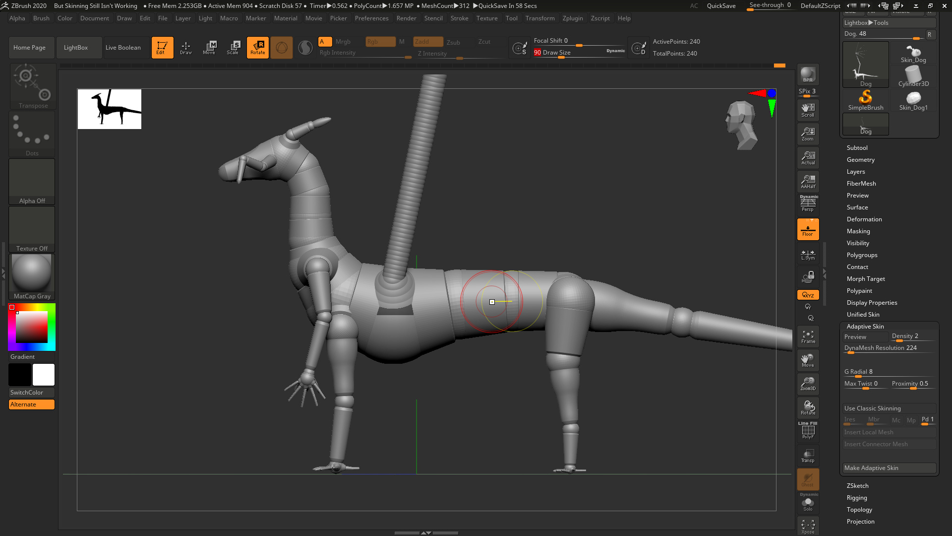

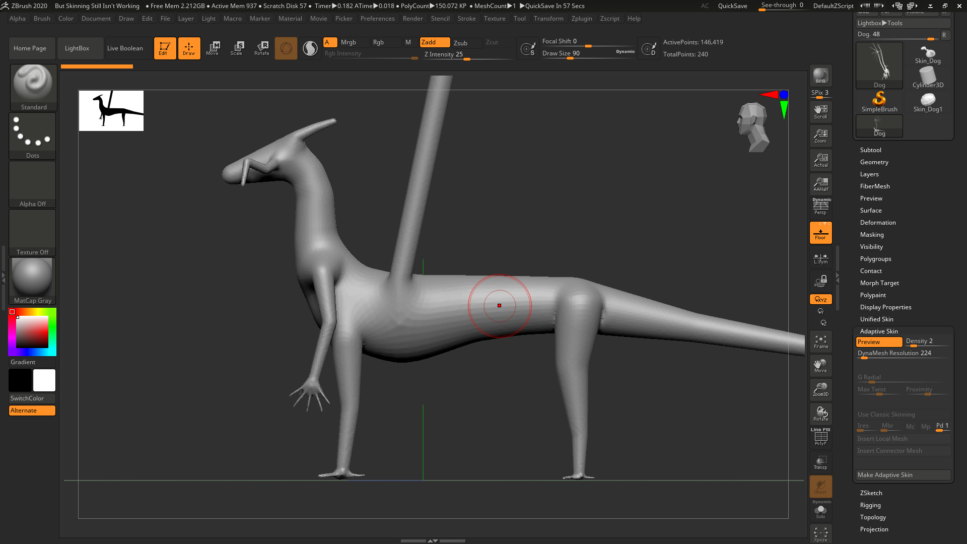

I created a ZSphere base for a dragon-like creature design I’m working on and after some playing with the Adaptive Skin settings I thought I had what I wanted, but then I realized that the volume was not accurately preserved; the mesh is a little smaller. Although I find that activating “Use Classic Skinning” worked well for the body, it messed up the wings while turning it off worked well for the wings but messed up the body. Is there anything I can do to get around this? I have a size 100 cursor in the same spot for size change reference.

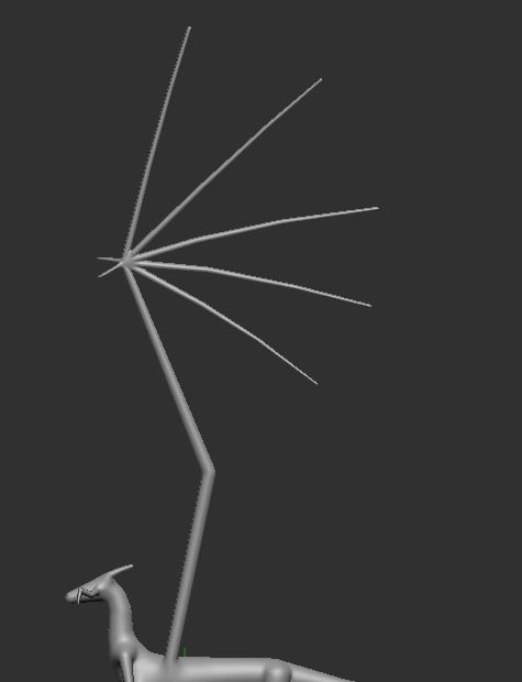

“Use Classic Skinning” does this to the wings:

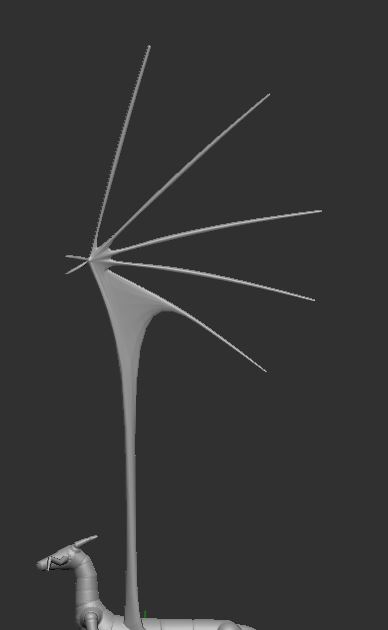

When I don’t have it on, they’re like this:
