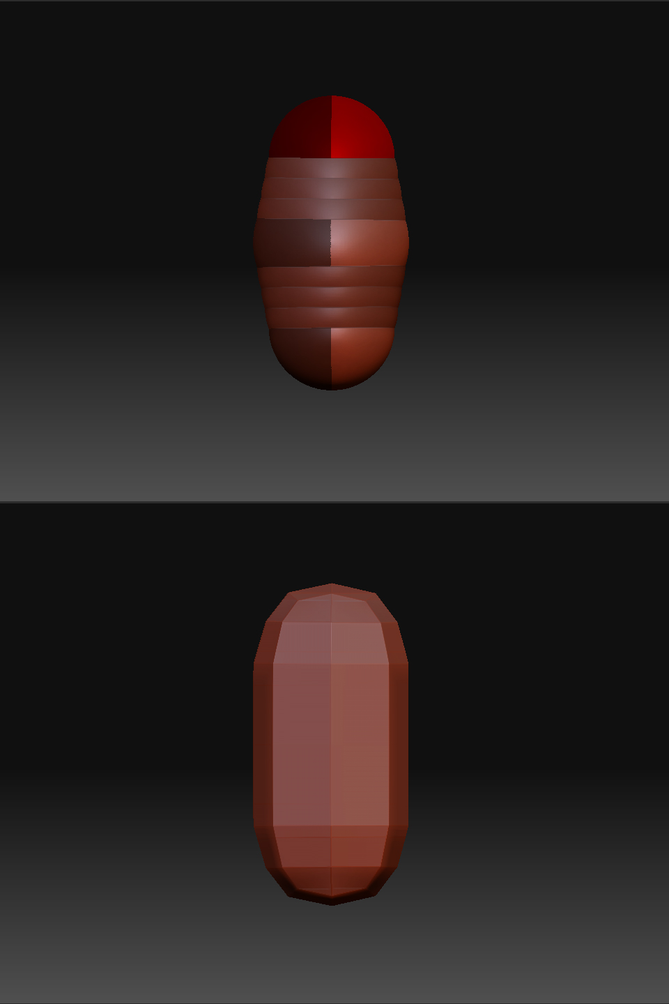

Draw your Zsphere,Hit edit,press the X key on keyboard,hold down shift and click on Zsphere.
you should end up with this.
both ends closed. :wink:
