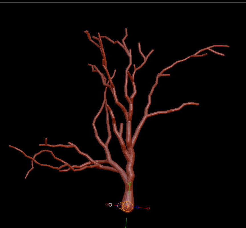

I don’t mind the colors , I just want to be able to assign polygroups… I know I could do it after but that would be time consuming. I am making a tree with many branches and i want to set a different polygroup for the trunk and other for the branches or the caps…thats the idea. If i have a tree with many of branches I dont want to go one by one making polys… the script is already working pretty good , I will keep posting stuff here. and thank you very much for the interes…
Interesting. Would you have a text version you’d share?
Sure, I sent you a private message.
well, I don’t think its possible to do what I wanted. ZSphere colors don’t mean adaptativemesh groups :mad:. I think they would be a lot more usefull if you could set groups and not just colors. masking doesnt work either since group by mask doesnt work with zspheres.
But what you do have is both quite interesting and amazing. Thanks for that, more to come
That’s very impressive and I’d love to try it if you feel able to share.
You can set the polygroup by applying the same timestamp to the zspheres you want to be in the same group. This doesn’t give you any control over the polygroup color. Also, it means that you can’t then use the timestamp to, for example, determine if symmetry was used to place the zspheres.
EDIT: Forgot to mention, when adding a color to zspheres you can just turn on Tool>Polypaint>Colorize.
HTH,
It’s pretty neat. I jotted a basic idea down(similar) a couple months ago, but didn’t proceed from there. Still playing with it here
oh Thats So good! Thank you! i will have to use that and change a couple of things! … i was planning to release the zplug after I write some instructions. But I m really bad explaining myself.
Just a couple minutes to do this. You guys and gals are going to love it once released
