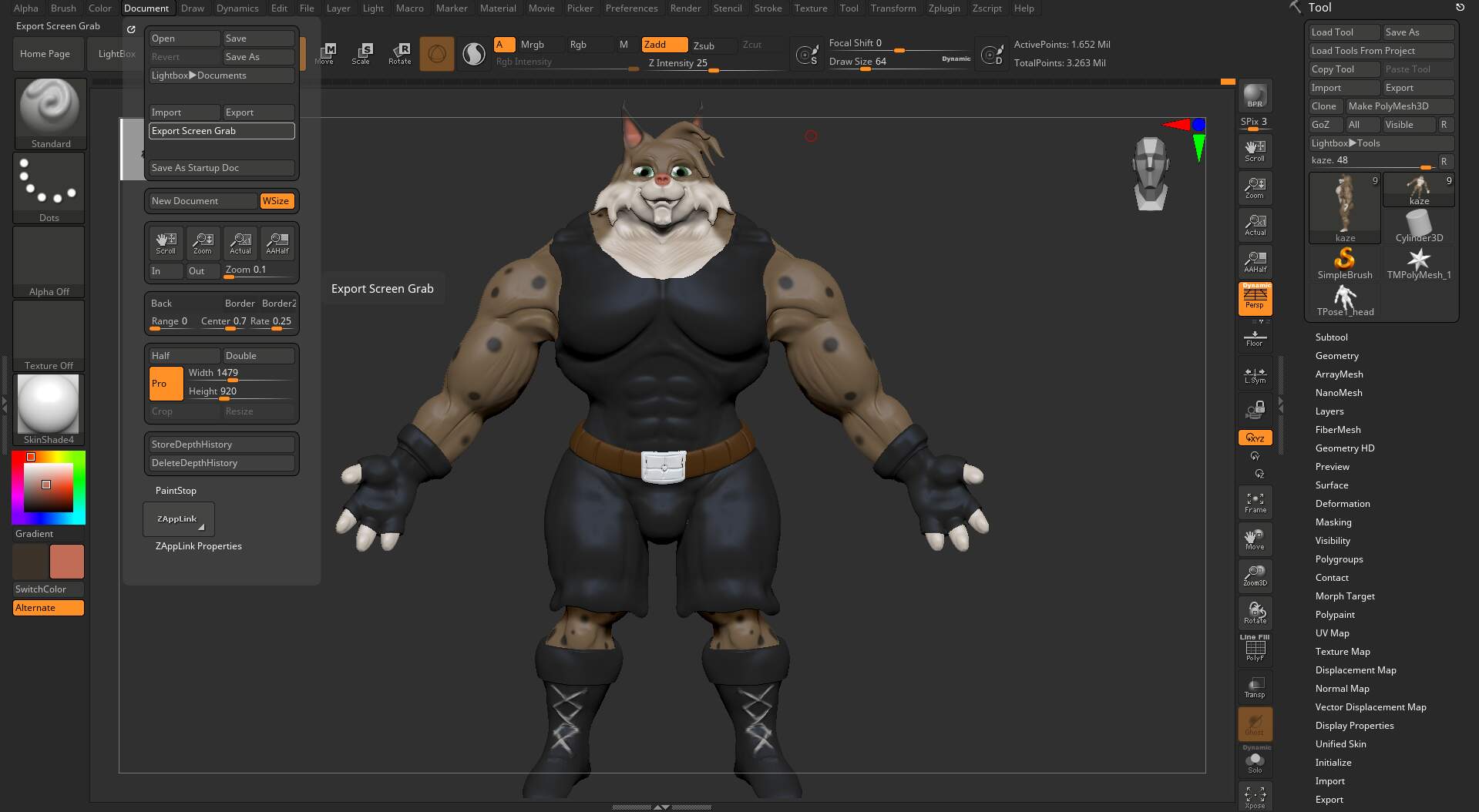

Once i have the model rigged i try to turn the and legs & arms they move very slow am i doing doing something wrong or could it be my PC

While it would be much more helpful to actually get a look at your model, the most common problem users have when suffering poor rigging performance is trying to rig/pose a model that is too high in resolution (polycount).
The higher res a mesh is, the worse it will perform when posing, and the more likely it is to suffer significant surface distortion. You really want to aim as low poly as possible for a posing mesh. The fewer points there are, the better it will perform, the easier the individual points will be to target accurately, and the easier it will be to repair any distortion that occurs.

Yes, that mesh is going to be too dense to perform well while posing.
There is no hard and fast rule, other than the lower the better for the most part. If you could ZRemesh to under 25k polygons, you’d probably be in good shape.
Posing works best with a mesh that has a low poly base level, and multiple levels of subdivision. However, reducing polycount also reduces detail. If you don’t already have multiple subdivision levels, the best thing to do would be to duplicate your mesh as a subtool, ZRemesh the duplicate, subdivide as necessary, and project the detail from the original mesh onto it. You can then pose the lowest level of subdivision, and those changes will transfer to the highest levels of subdivision.
