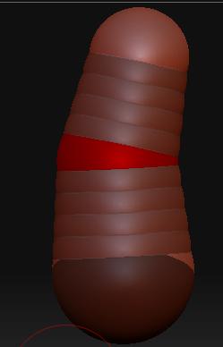

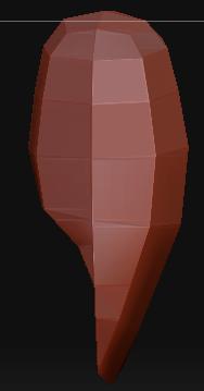

First off, when I use Zspheres, often the “main” sphere doesn’t show up when I hit “A” The linked Zspheres will show up fine, but the original one I started with doesn’t show up. Oddly enough, when I make models with quite a few Zspheres lniked to the base, this doesn’t happen. Anyway to fix this? (I think I described this like crap, so attatched are two photos.)

  1. The root ZSphere (the first one you draw on the canvas) is a placeholder. It has no geometry of its own. This allows you to create meshes with a closed end or leave it open depending on whether you cap the root or not.
