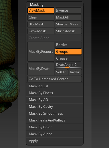

Cheers but I can’t see the Autogroups function anywhere?
autogroup
That’s because for some reason I sent you to the Masking palette to look for Polygroup functions! :wink: You are looking for the Tool> Polygroups menu.

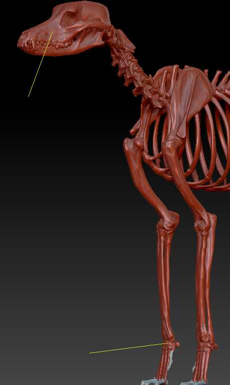

Dear @marcus_civis & @facelessmindz . The subtool works very well thank you. Some more questions if I may.
I wish to remesh this model which consists of multiple subtools:
different
As you can see within the same model, there are subtools that are complex/ big like the skull, and subtools that are very simple like the simple/small bones in the leg that require different polycounts to capture all the detail.
  1. at the moment it seems as though, the subtool will go through & remesh according to the Zremesher settings that it encounters on the first subtool. I tried setting the subtool settings to different values (target poly count 30 for the skull subtool & 1 for the small bone subtool) but all of the remeshed subtools came out around the same values. Is this expected behavior for the macro?
  2. it seems as though the macro will Zremesh any subtool present in the file, regardless of its visibility status. Is this expected behaviour & if so, is there a way to modify the macro to only Zremesh those subtools where the status is set to visible? (this would allow me to first Zremesh the complex objects at high polycount, and after the simple objects at low poly count)
  3. if I were to remesh all of the subtools at a high polycount (20k) - is it possible to go through & Zremesh the smaller subtools that need less polygons, at a lower polycount, without losing details from the original high res subtool? Or when you Zremesh an already Zremeshed subtool, does it use the original subtool or the first Zremeshing as the original topology?
