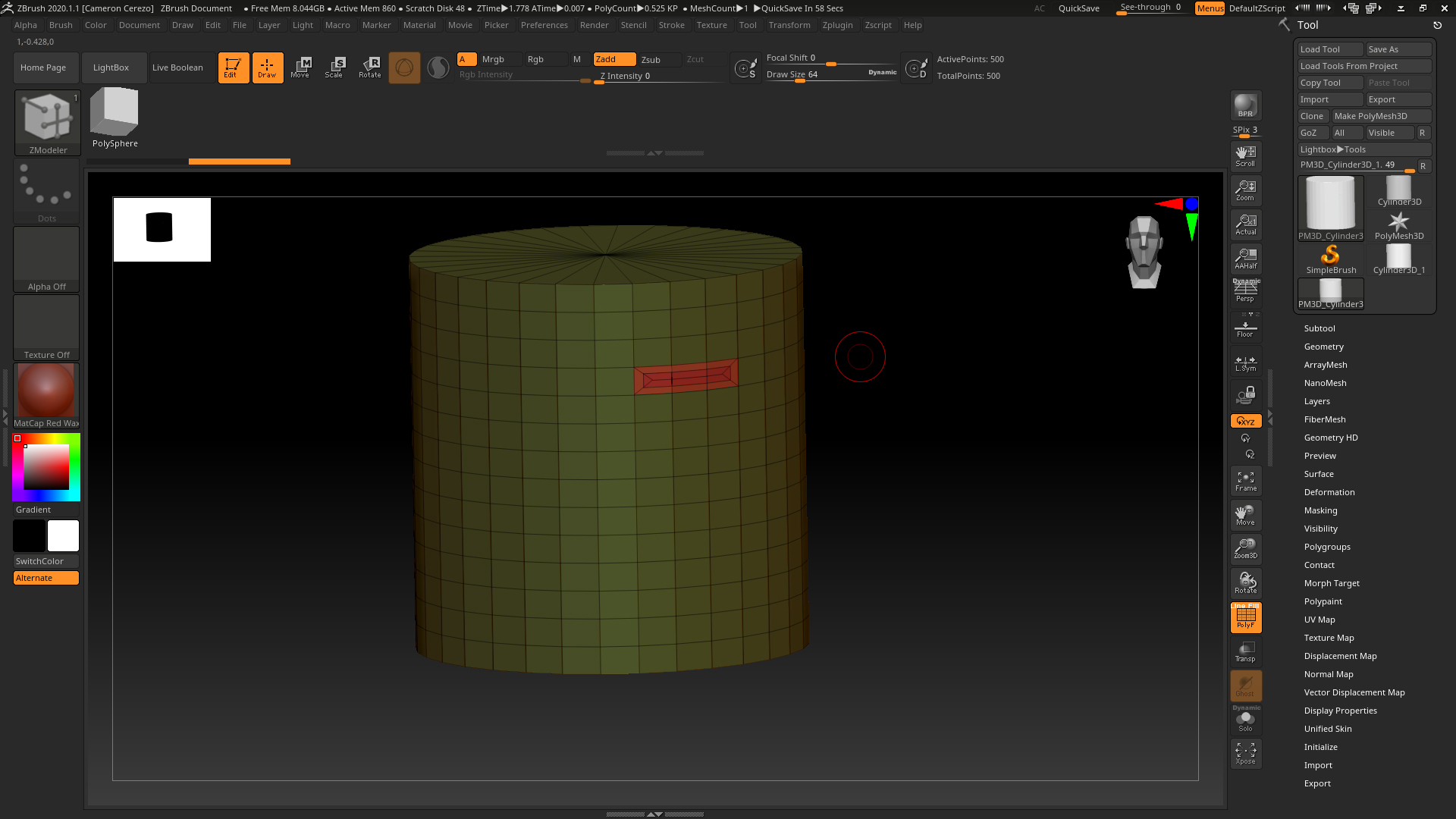

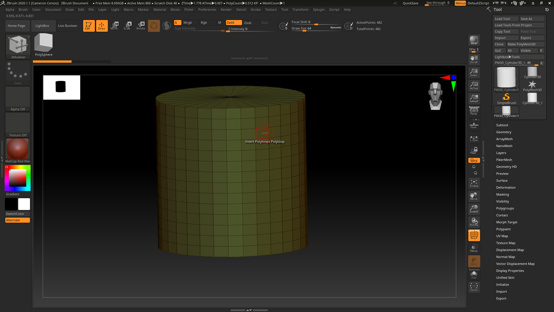

Okay here are some screenshots. This is just on a normal cylinder, I get the same result no matter what I’m working on.
Thanks for the quick response!
Ok, I’m going to guess you’re using primitives with radial topology on the end caps. This tends to confuse a number of operations with Zmodeler. Try switching to “Grid mode” or “Sunburst mode” in the options at the bottom of the Insert polyloops tool. This should produce different results.
Otherwise, I’d recommend a different approach. Edge > Insert Loop should work better at least for the loops on the side, but it too will be confused a bit if you try to insert a loop that involves the topology that meets in a single point at the top. It can’t read a clear loop when that radial topology is involved.

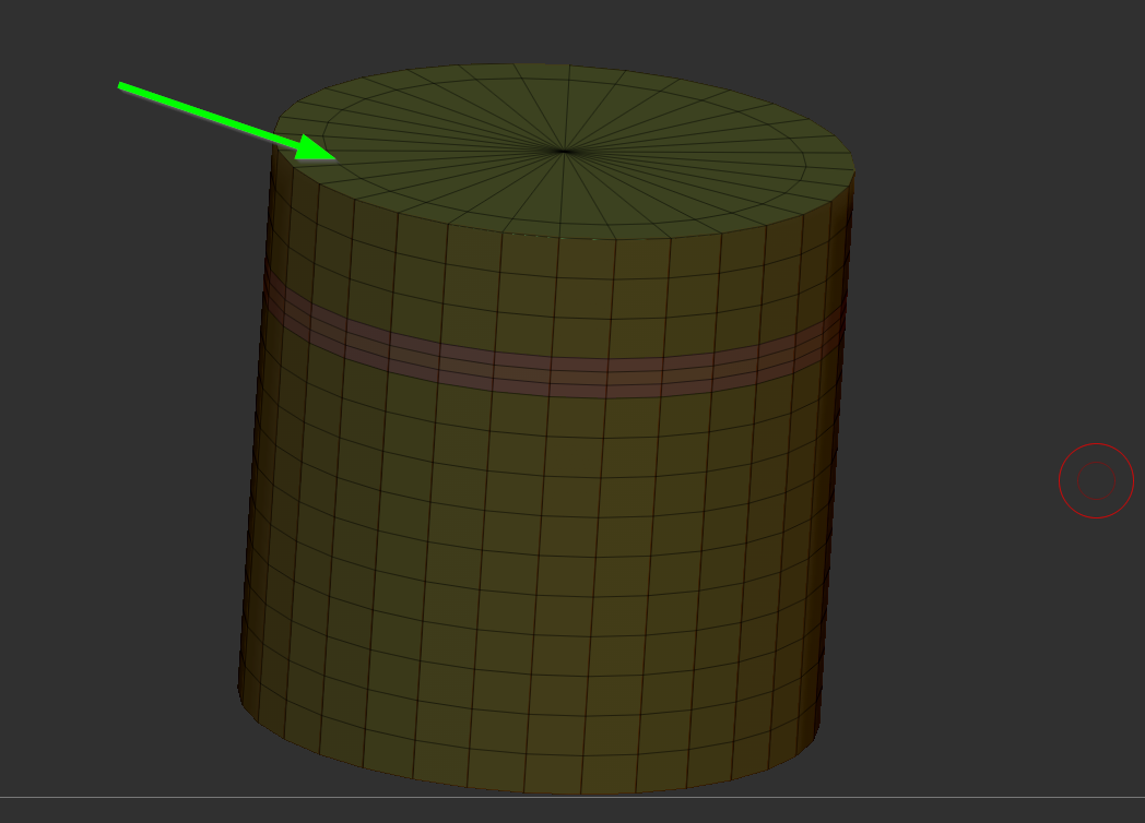

It definitely has something to do with the triangles in the end caps. If you hide and delete the end caps, it works ok. If you insert an edge loop in the end cap near the corner, it works ok. If you use a QCylinder, it works ok.
