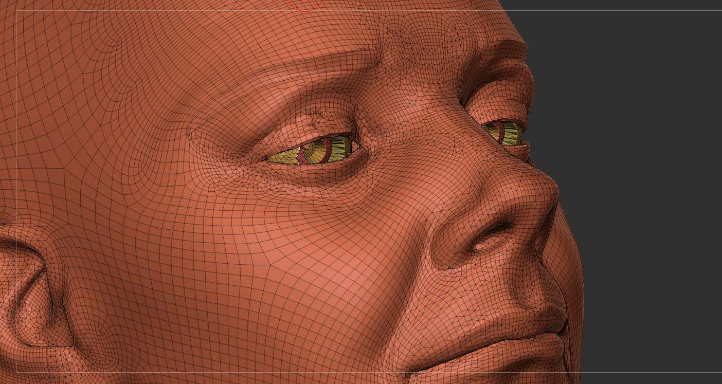

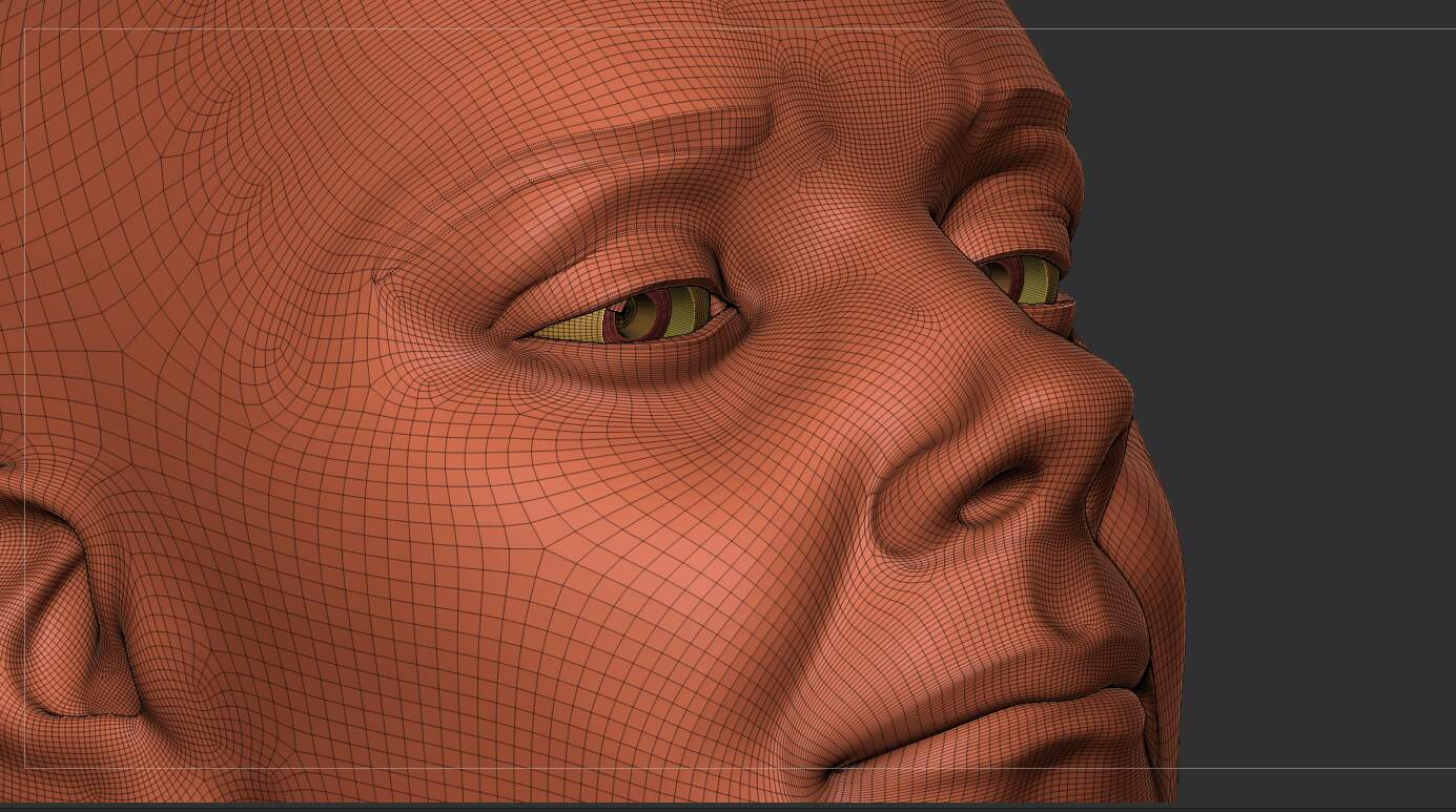

Here is what it’s done with face and especially eye geometry after attempting to attach a character head. First image is clean geometry, second has new triangles, holes punched through the eyelids, and the eyeballs and lids merged into a single object via weird broken geometry.
All of the various settings for bridge appear to use this new corrupted method, as does edge extrude. There’s no way to simply “Bridge” something anymore without also destroying a lot of polygons.
Any ideas?
