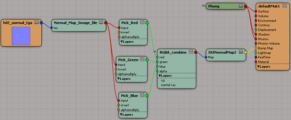

](javascript:zb_insimg(‘123582’,‘NormalShader.jpg’,1,0))
There is the shader I built. Normal map>image node>color channel split (to flip channels if needed)>channel combine>into normalbump>into material bump slot.

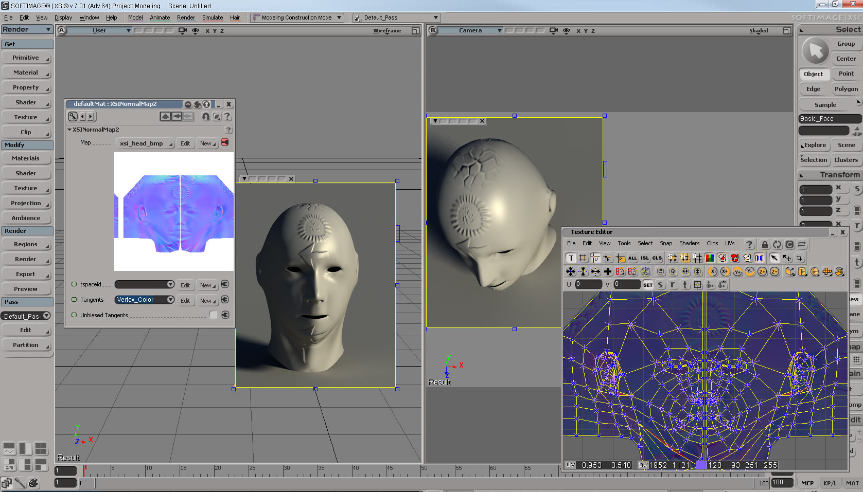

hrm, I must have a magical version of XSI then :lol:

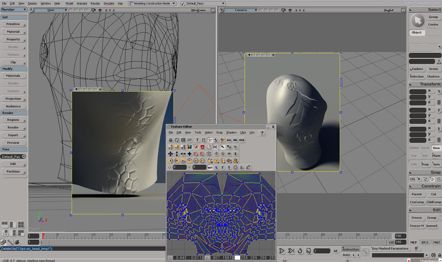

lets play a game… i call it “find the seam”
I purposely left a huge gap going right down the center of this XSI-face to prove my point. Yes, you applied a tangent property- but are you using it correctly? Here’s my workflow in case it helps you guys:
- sculpt like normal, when finished either export level 1 subd or switch back to morph target (whichever workflow you use)
- open up zmapper, load the Maya Tangent Space (best quality) preset
- change the display mode to tangent so you can see the seams
- on expert pass 2, crank up the smoothing for all four sliders (UV’s/groups). Also play with the different tangency modes, whatever makes your seams less visible is what you want- typically i’ll go with short triangles.
- go to the normal map projection and turn on ray visibility, make sure the rays are not clipping.
- capture the current mesh
- calculate projected normal map.
- Load up XSI and import your level 1 mesh
- Apply a Tangent property to your mesh
- give it a material, and drop an XSINormalMap2 node on it and plug it into the material’s bump slot. Select your normal map as the map input.
** if you render it here, you will have seams! My guess is that this is likely where most people are screwing things up *** - inside the normal map node, next to the Tangents dropdown, click NEW and then color at vertices.
- Uncheck unbiased tangents (or leave it checked, depending on if you want unbiased tangents
- render
That’s why you don’t have seam. If you would heal the islands together, and let the seam happen at only on the back of the head (or under the chin, etc) you would have the seam. In games you have to map your face with the least islands, to have an efficient vertex data quantity. So let’s play further, let the head have one continuous island, with the seam at his back, and render that. I have no problem with a similar case, you introduced us. Lately I had a commission to make a character for game, but I had to render it to the client. When I was ready, and the character was OK in the viewport, I realized, that the render sucks. I had to render it in max (what a shame
right, because a seam isn’t a seam sometimes.
just for arguments sake I’ve wasted an additional 20 minutes of my life to put together the following screenshot further hammering home my point. If this doesn’t convince you that there’s nothing wrong with XSI7’s normal mapping, then you deserve to be going back and forth between three software packages to get anything done.
](javascript:zb_insimg(‘124118’,‘noseams2.jpg’,1,0))thx testure …
Testure, thanks for your extra 20 minutes, it helped me a lot! Stupid me, shame on me, and ash over my head, that I was so stupid…
