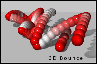

Here is the next version. Now you can bounce in 3d. Just turn on Zwalls in the Zwall menu and you are ready. You can build an object out of it with “MarkIt” and then then move the whole thing around. I have posted a sample image below.
Thanks again for all the input
//Edit
Ok, I think this will be the final version as I can not imagine there being any real use for this. I have just gone in and cleaned everything up, improved the random features (thanks marcus). If for whatever reason you are playing with this and find a way to break it please let me know as I would like to have it as functional as possible.
Thanks to all for the comments, look forward to doing some more Zscripting!
