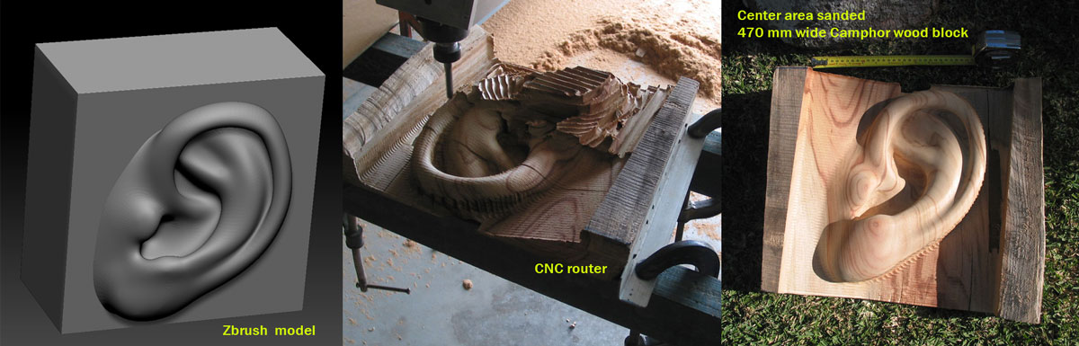

I finally got my machine to the state where I can make pieces. Here is one of the first things I have cut from a zbrush model.
[[attach=254108]Zbrush-to-Wood.jpg[/attach]]Zbrush-to-Wood.jpg

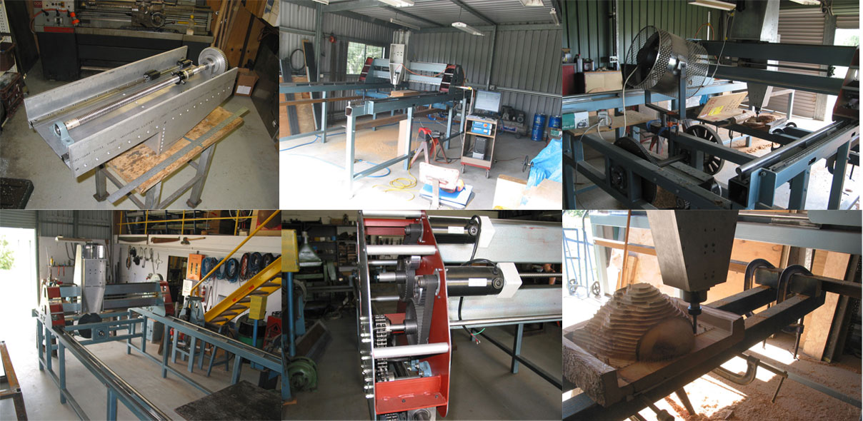

Here are a few pics of the machine during construction and testing. I had to use a 3 Hp spindle because of power limitations at this time. It was designed with a 8.2 Hp unit. It looks a bit like a rat rod now because I couldn’t wait to play with it. Cosmetic finishing will come later. Don’t have a vac system so I put a partially built studio fan behind it and just blow the dust out the door! (don’t have neighbors). I had the space and the material so I built it big. The usable area is about the size of a Ford Pinto (American standard) or 1600 mm X 3000 mm X 1200mm (rest of the world standard).

You should be able to mill any material with it, or just for wood?
Did you design and build the machine? or order a kit? any info about it would be great :slight_smile:

Tungerz, I designed and built it for wood only. It’s not heavy enough for metal. I use DeskProto to write the toolpath and Mach3 to run the machine.
DeskProto is one of the best apps I’ve used. It has a very intuitive user interface and it’s the right price.
holyjewsus; the only tip I have is to jump in and do it. My machine is a four axis, I haven’t put the tail stock on in these pictures. 5 axis is more than “one step beyond” :slight_smile:
