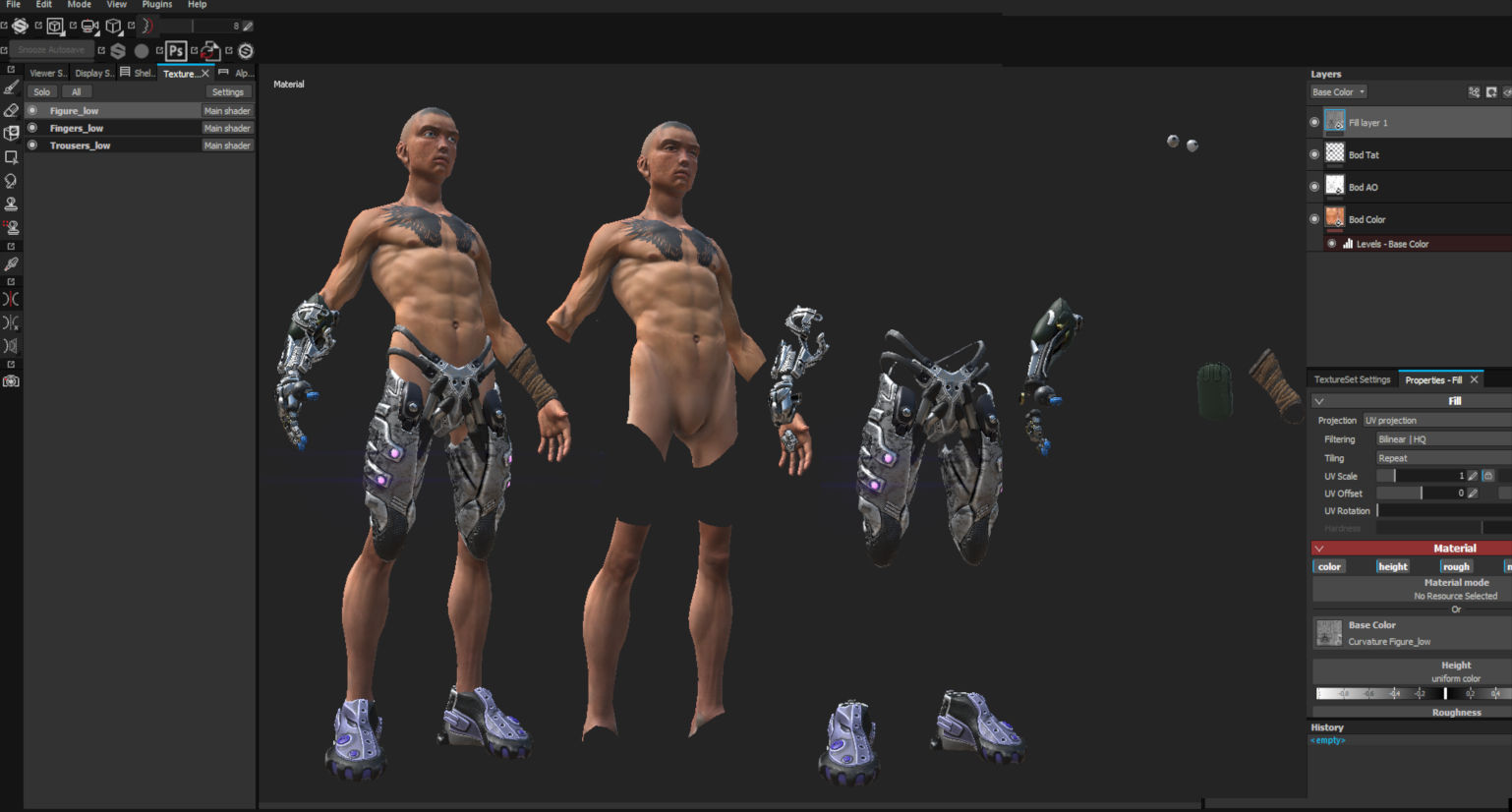

Its usually a good idea to break your model down to 2 or 3 parts for baking if it is complex. How the model is broken down depends on its construction. You can bake in substance painter without having to use a cage but you have to make sure that the pieces are whole and not adjacent, or you get anomalies.
Here is a breakdown I did with a character. The piece is broken into 3 texture sets.
I think your suspicions are corect in that 30 texture sets is a bit over the top. Try and optimize your model more until you are down to fewer parts.
