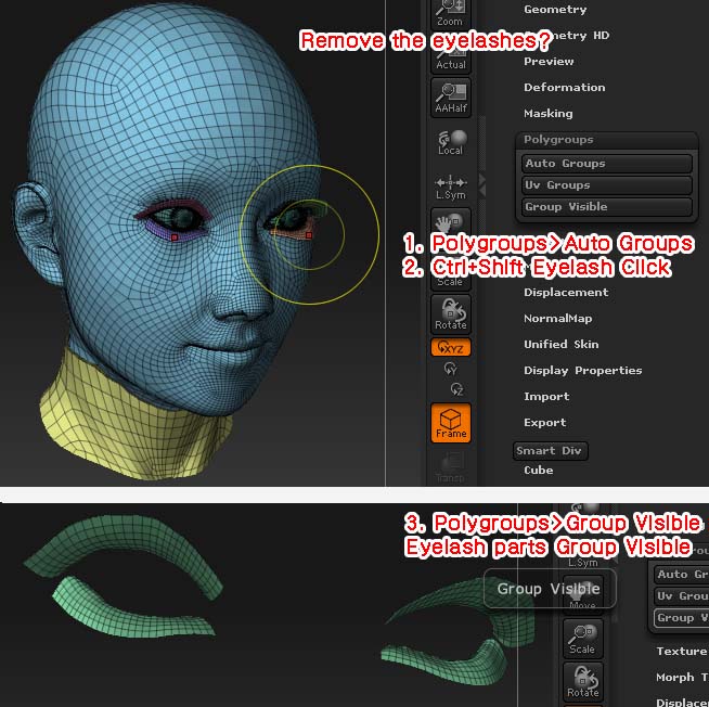

How do i remove the eyelashes,…???
Hi BeerKeeper
Remove the eyelashes to ZBrush.
  1. Polygroups>Auto Groups
  2. Ctrl+Shift Eyelash Click
  3. Polygroups>Group Visible
    Eyelash parts Group Visible
Bear in mind that if you delete the eyelashes, and they are actually part of the head…and then try to use the remaining geometry as a morph in Poser you will get the “wrong number of vertices” message.
Best to isolate the eyelashes imho.
Best of luck

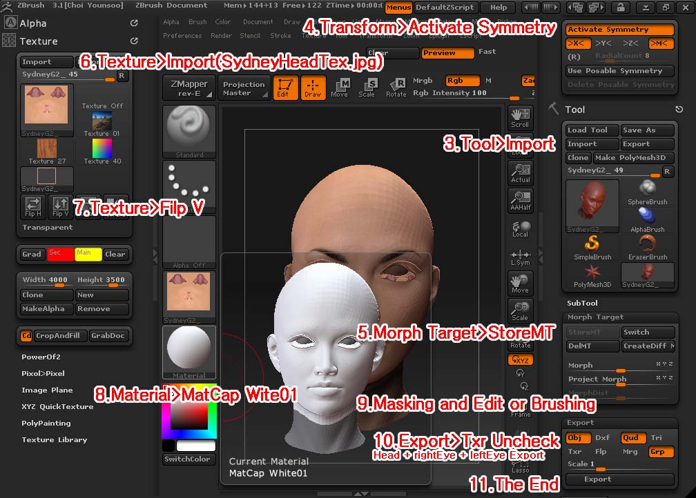

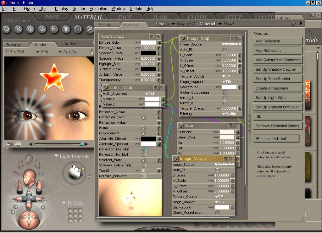

How do i apply in zbrush texture for sydenybodytex and sydenyheadtex together. When i apply the second one it rewrittes the first one,…
Hi! BeerKeeper.
I do not English write well.
sydenybodytex and sydenyheadtex together <<<— No!
Apply in zbrush only one texture. <<<— OK!
thnx ,…i read somewhere that it must be aplied seperated, ( head and body ), and then imported back to zbrush and merged together

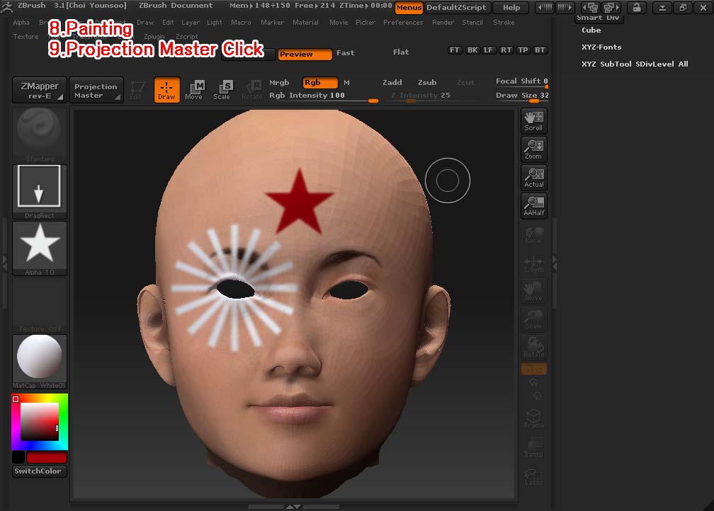

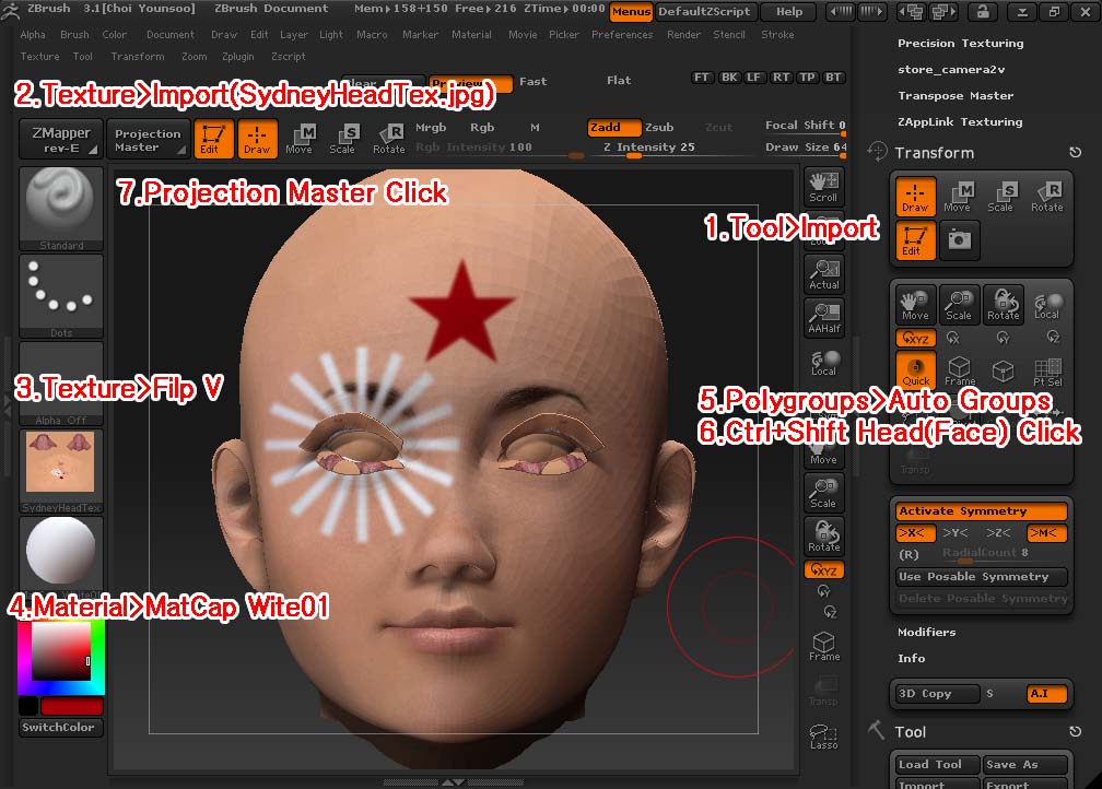

Hi! BeerKeeper.

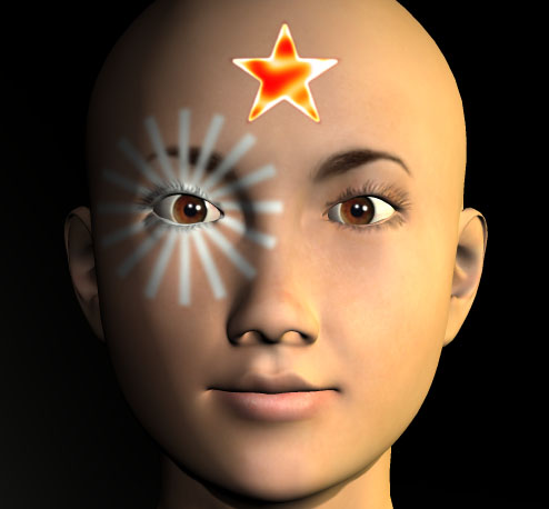

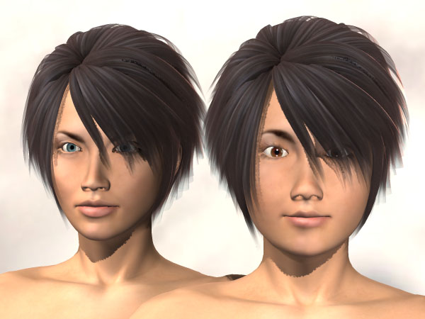

This is My Head painting test.
[attach=81007]Head_Texture01.jpg[/attach]
[attach=81008]Head_Texture02.jpg[/attach]
Render :slight_smile:
Great!!
Poser render?
the name of her dealer?
Yes!
Poser 7 render…
[attach=81015]Render4.jpg[/attach]
