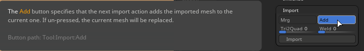

Additionally, you can also import the mesh like you do it now, but you gonna have to :
  1. duplicate the current subtool
  2. in tool : import, enable Add button.
  3. press tool:import, it will just replace the subtool you had duplicated and import directly into the current subtool, instead of having to switch to the polymesh3d.

The add function is quite nice. Then I would always have to separate the 2 models in the subtool and make two individual subtools.
