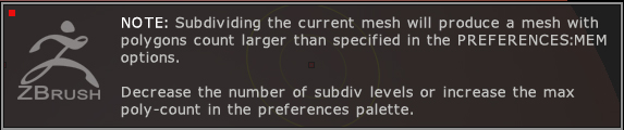

[level.jpg](javascript:zb_insimg(‘202064’,‘level.jpg’,1,0))
Don’t increase manually the maximum polygon count from “Mem” options.
If u try to increase, it will cause the above problem.
Best suggestion is,
use default values, and use HD Geometry to minute detailed sculpting.
