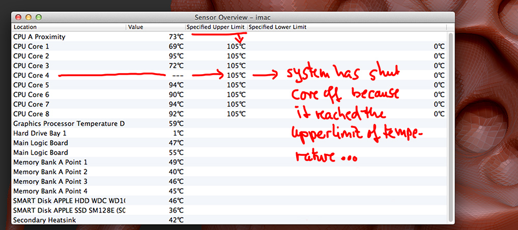

so, i got an app to read out all the temperature sensors inside my machine. my machine started with core temperatures less than 50 degree (celsius) on each core:
zbrush raised within 5 minutes the temperature of all cores close upto the max allowed of 105 degrees, the system then shut off already one core, because it reached the critical limit. when i work further, more cores get shut off.
so, what is that??? zbrush should not heat the machine that much when it is used almost in “idle mode”…

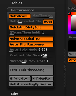

What are your Zbrush settings in the Preferences->Performance tab?
You upgraded your OS as well? Fans not running would lead to overheating, it does on a car.:wink: Any way to check status on them as you have for temperature? It might have to go to the Mac store. :frowning:
i never touched the prefs performance, here is what they are set to
