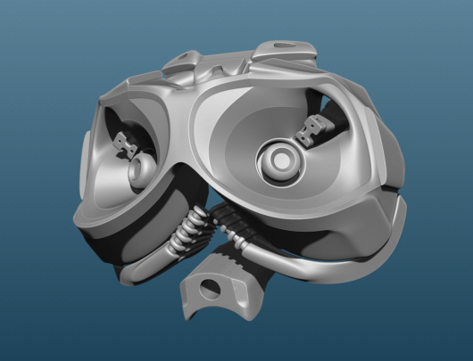

I have this piece, made in LowPoly with Zmodeler. I wish to send this to max, keeping the complex edge creasing structure as smoothing groups. I know this is not a problem from max to zbrush, but is there a way to export these creasing info from zbrush to max?

Thanks for replying ! Actually I creased partial edgeloops using the zmodeler brush. so it’s more complex, they’re not the entire seems of a patch, but a mix of hard and soft… (wich can be done in max by assigning common and separate smoothing groups on 2 polys sharing the same edge). Remaking it manually in max is possible, but not so fun at all.
