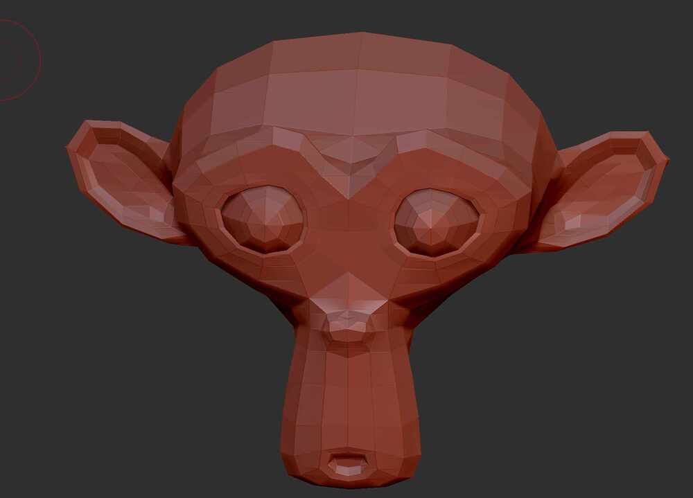

If I import Suzsanne from Blender to zBrush it looks like it should look:

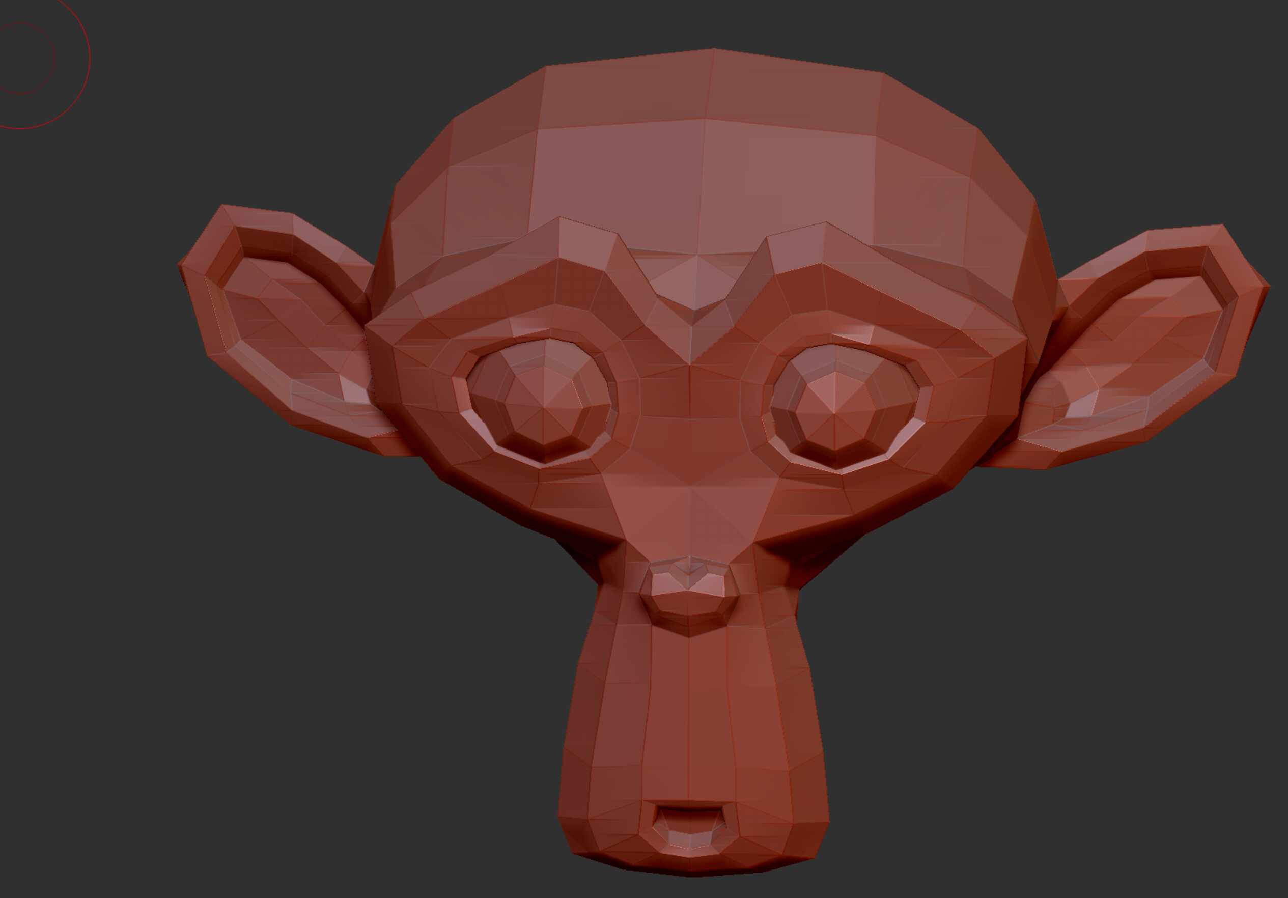

I can reconstruct the subdiv and switch between the subdivision levels. Everything looks fine, like here, the lowest reconstructed subdivision level:

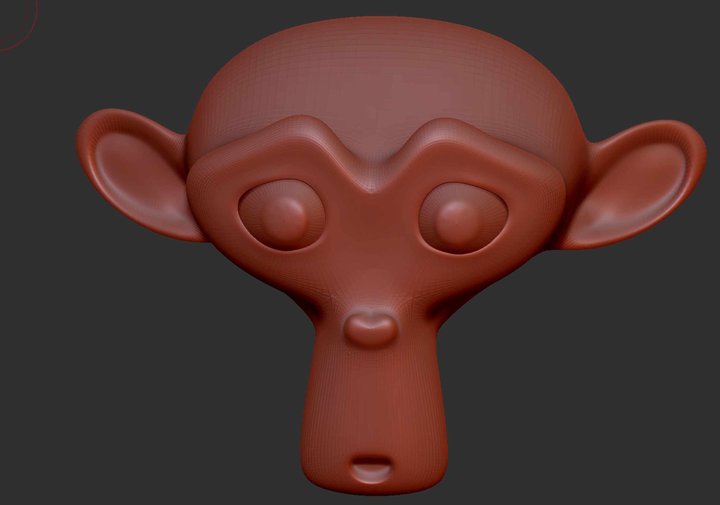

But if I delete from the lowest subdivision level the higher level sand subdive again things get off.
The highest one lost a noticeable amount of volume, compared to the original:

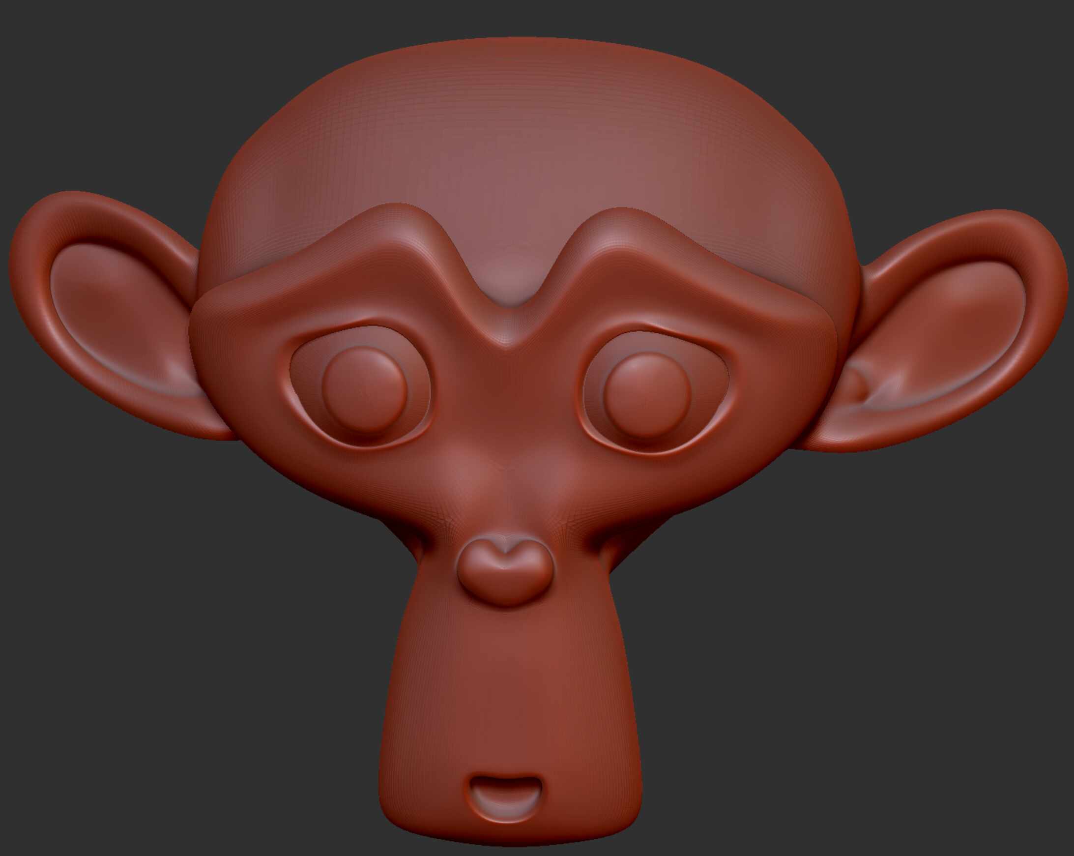

and also the lowest level seems to be affected:
