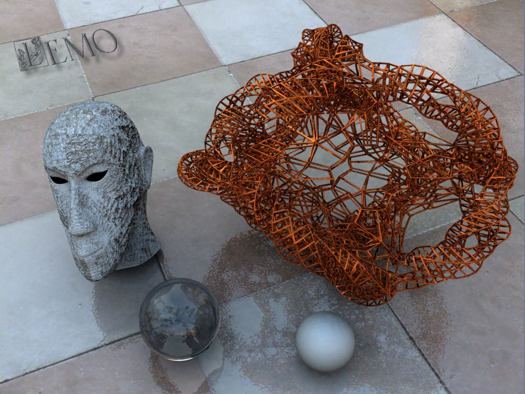

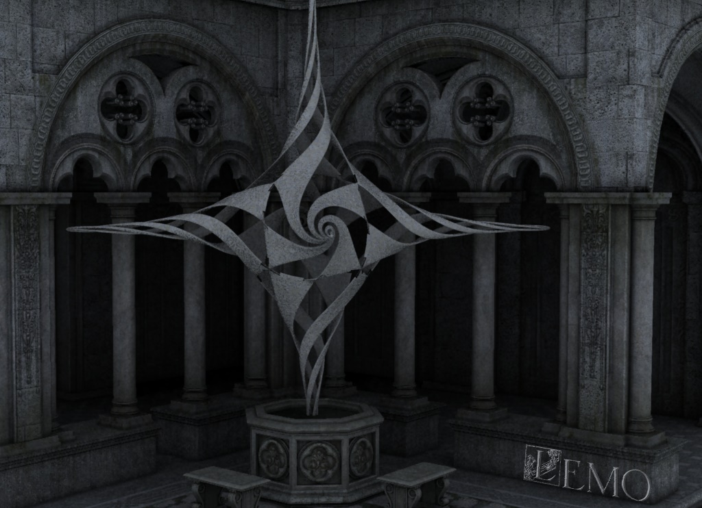

After the first update of Hexagon 2 I went and got Carrara 5 as well… Way below the original 600$. First it’s on sale and second the Platinum thingy from the Hexagon deal subtracts another whopper…
Download install, no problem. Loading my models… no problem… Problem? yes, not enough time! 8-).
The two attached renders are done within the first half an hour. With all the presets it’s a very easy system. I’d say a joint of Poser 6 and VUE5 and Hexagon2. Can’t say much but it obviously works. Didn’t die on me yet either. Another surpriding deal from DAZ. Here are the pics… no postprocess and I honestly am not really in control of the program… Oh, and yes, the models from ZB loaded without a hitch, textures and everything showed up on the push of a button.
Cheers
Lemo

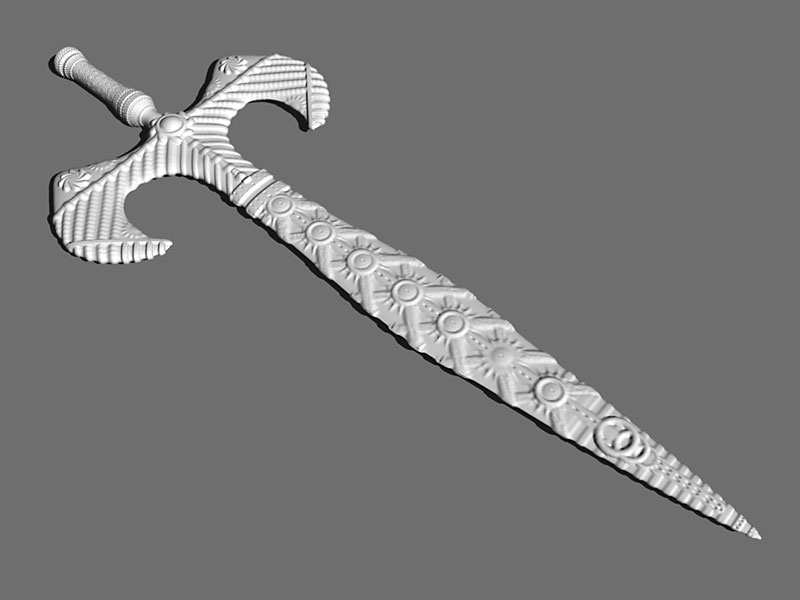

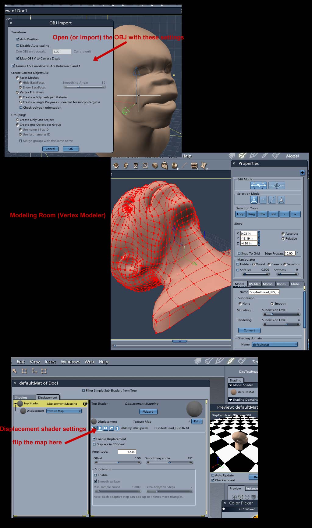

ZBrush displacements in Carrara 5 are easy.
Import model as a vertex object. In the Vertex Modeler select the whole object, click the ‘Model’ tab in the ‘Properties’ on the right and click the ‘Smooth’ radio button. Set Rendering subdivision level to a reasonably high value. This render used a setting of 6.
Switch to the Shader Room and click the Displacement tab in the object’s shader. Select ‘Texture Map’ and choose your ZBrush disp. map; flipping it will probably be necessary. Amplitude setting here was 18 but 12 is generally sufficient. If you use the Disp. Exporter then you can adjust there. For ZBrush disp maps make sure you don’t enable subdivision in the shader.
Render and you’re done.
Any problems, let me know. :slight_smile:

…for this ZB sword rendered in Carrara 5?
And for Lemo’s image?
My Images took less than 2-3 minutes each. On a more moderate PC I’d expect less than 10 minutes each. With a good understanding of ZB and the terms, it’s easy to control… I’m having a blast…
Lemo
PS:Yes Bicc39, we are in the same boat 8-). But I think I lead with 1 Modo hahaha.
The ZB sword only took a minute or so, on a pretty low-spec machine.

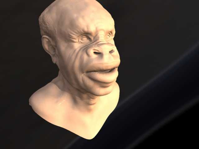

Mr Civis,questions if you would.
When the displacement map is created for Maya. it is exported
in a tiff format, opened in photoshop and converted to an rgb
format. Note is made of the alpha gain, the image is flipped.
When exporting the map for use in Carrara what procedures, if any.
should be done.
Am exporting and working with a head that is basically 5000 poly.
During experiments with using the map keep hitting memory allocation error.
My machine has 1gb ram and this message is unusual.
To double check the settings with you.
  1. Smooth 2. Rendering subdivision level ( you specifiy 6)
  2. Amplitude about 12 4. do not enable subdivision in shader.
    Cannot pinpoint the cause of the memory errror, If numbers are lowered. error message disappears, render shows no displacement.
    Many thanks your help and your time.

It may be that C5 is choking on the level 6 smoothing - that’s equivalent to over 20 million polys for a 5000 poly mesh - (although that wouldn’t explain why you get nothing when you lower the figure). You should only need a figure that is comparable to the number of levels you had in ZBrush. The slider is effectively multiplying by four each time. (I could use 6 for the sword because it is only 340 polys.)
Carrara 5 can cope with 16 bit grayscale tifs straight out of ZBrush. You can flip them inside Carrara (see my pic).

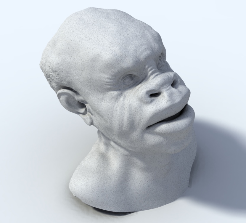

Here are my settings for Pix’s displacement head test in this thread which you might try to get things working.

Had to lower the Rendering level to 4 error message at 5.
Amplitude 12.

Looks good! :slight_smile: I only used setting 4 myself for the rendering subdivision - it’s a higher low poly model than the sword - something over 3000 polys.
