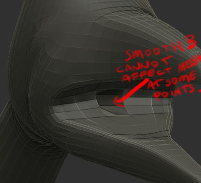

Here is the image of mouth of a dinosaur. I wanted to make them deeper, to give appearance as if they go down to the digestion system, but this thing with smooth brush gives me hard time.
Perhaps that small area is masked. Mask>Clear Mask. If that doesn’t work, I would suggest setting up some polygroups so you can isolate the mouth interior.

you might want to turn on Stronger and/or alt brush size in the brush settings, strength of the smooth brush is also controlled by its edit curve now. usually for points that are so far in, its better to hide the surrounding mesh and do the smoothing from the inside, directly on the point.

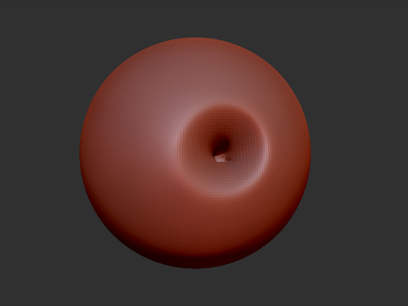

Here is a pic of regular Zbrush sphere tool.
I took standard brush, and with Zsub I sculpted small hole in sphere, and then took default smooth brush, and this is how it looks, no matter how big or small draw size or focal shift is, I cannot smooth deepest parts of mesh.

In case of the hole like in the sphere from the image above, it works, but only if the hole is not to deep, but If I have a hole that is deeper, or surrounded with more mesh, like from the first example in mouth of a character smooth brush is useless.

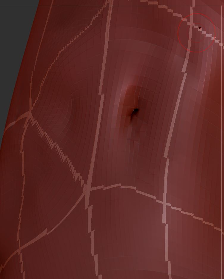

yep, ive got the same hole problem. i dont know how to fix it either. im also using 3.5R.
i was using the slash brush alot and smoothing as i went along. and ive smoothed everything. all appart from this hole.

ive just fixed it. dont know if this method will work for you though.
i pulled all the vertices out the way with the move brush. leaving just the one vertex point, i then by just using the standard brush on the highest z intensity for a while. visually it just looked like it wasnt going anywhere appart from dancing around in the crator i made. but eventually it came to the surface, and then i just smoothed it.

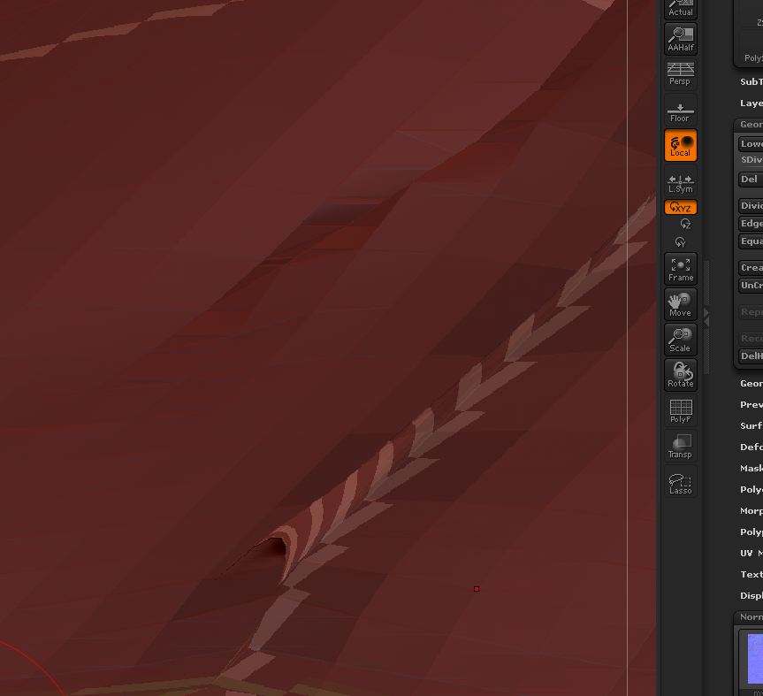

I have developed a crease.
does anyone know the answer in flattening this problem out please. ive tried the smooth tool and even tried to pull the seams appart with the move brush. also just using the normal standard brush to enlargen the seam to try and smooth it out. but still I cant fix the problem.
