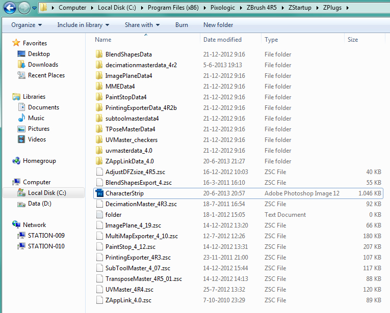

Can you post a screenshot of Windows Explorer showing the contents of your Zbrush 4R5 \ZStartup\ZPlugs folder? I should then be able to see what the problem is.
Thanks,
Dear Marcus,
here is the Screenshot of The ZBrush 4R5\ZStartup\ZPlugs folder
Thanks. I can’t see anything wrong there. Try installing the update again -

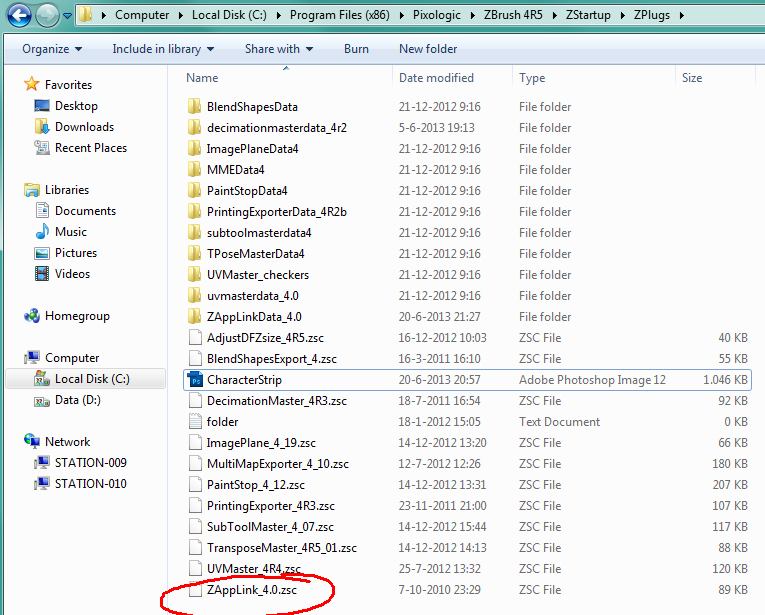

To install the update to ZAppLink:
  1. In the ZBrush 4R5\ZStartup\ZPlugs folder, delete the ZAppLink_4.0.zsc (circled red in the attached image). Don’t touch anything else.
  2. Download the ZAppLink 4R5 update here and save to your Desktop.
  3. Unzip the file, open the containing folder created by the unzipping and locate the ZAppLink_4.0.zsc file.
  4. Copy the ZAppLink_4.0.zsc file to the ZBrush 4R5\ZStartup\ZPlugs folder.
  5. Restart ZBrush.
