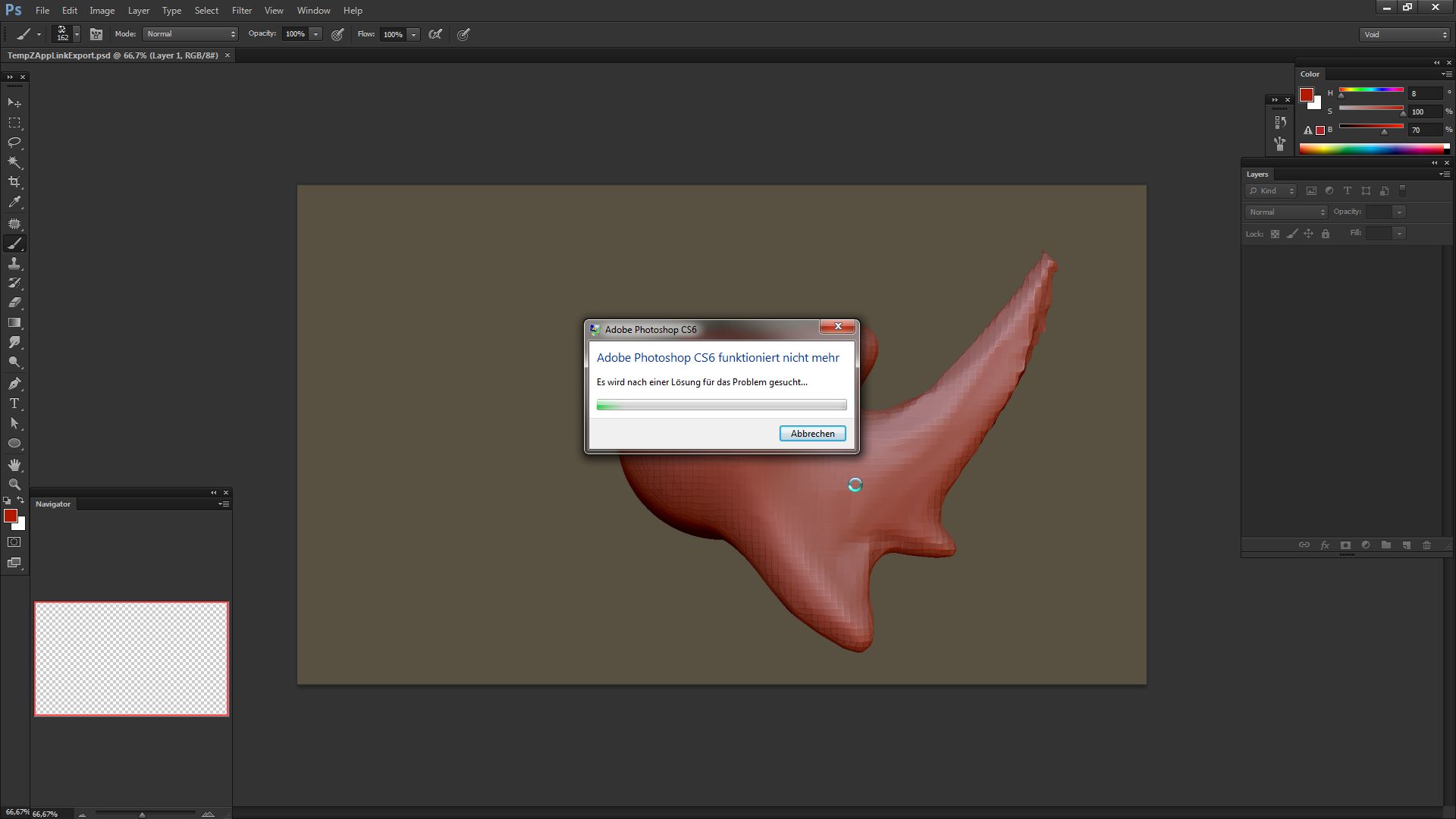

Recently my SSD died weirdly and I had to reinstall windows & Zbrush on the new one and now I can’t get Zapplink to work good again. Maybe it’s because this time I installed first Zbrush and then Photoshop, while the other time the other way around… i don’t know. What happens is that after Zbrush sends the data, i see a screenshot in photoshop but right after that and before seeing the layers Photoshop crashes. This used to work before flawlessly.
The weird thing is that if I create multiple views and check “Zapplink Views” the document menu it works, and it does send in multiple layers without crashing Photoshop. Stumbled upon this less than perfect temp solution based on a report of the problem from a few years ago, but I’d really like to be able to send just one view quickly without the additional steps and layers. Thank you in advance! Can’t wait for 4r7!!! :smiley:

I don’t see how your answer applies to my question. I knew that and even said that above that with a tweak in the Document palette I can get it to work again … but in an undesired way, which is to say it only works if I first manually set and then send multiple views, not as it used to/should just by clicking Zapplink with the current view. The send partially works, the image does get into photoshop, it’s just that Photoshop instantly crashes after that, before I can edit the image. All other documents work normally in Photoshop (CS6).

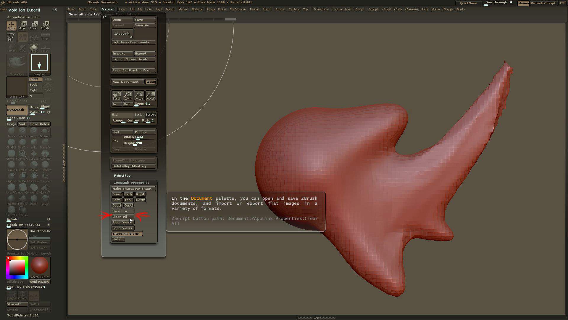

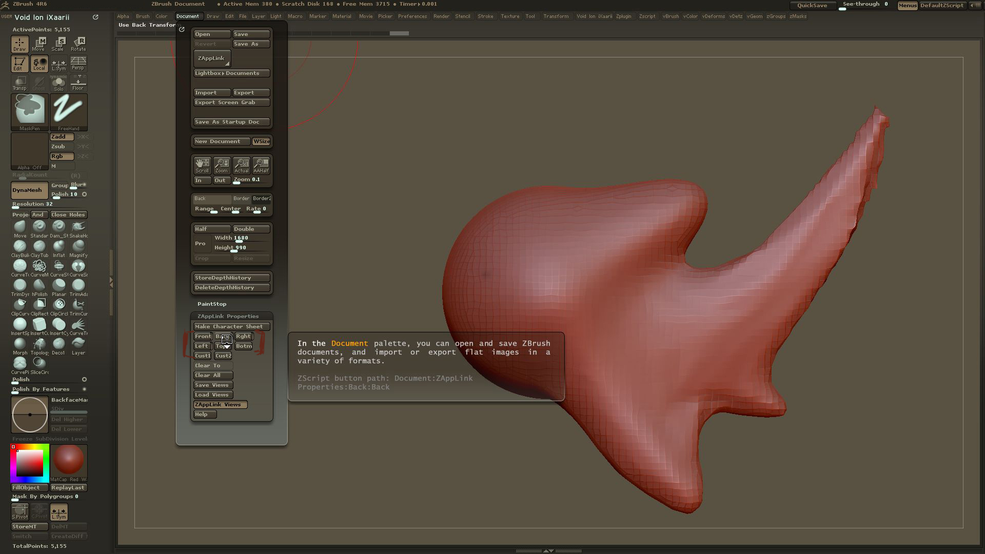

  1. click on zapplink

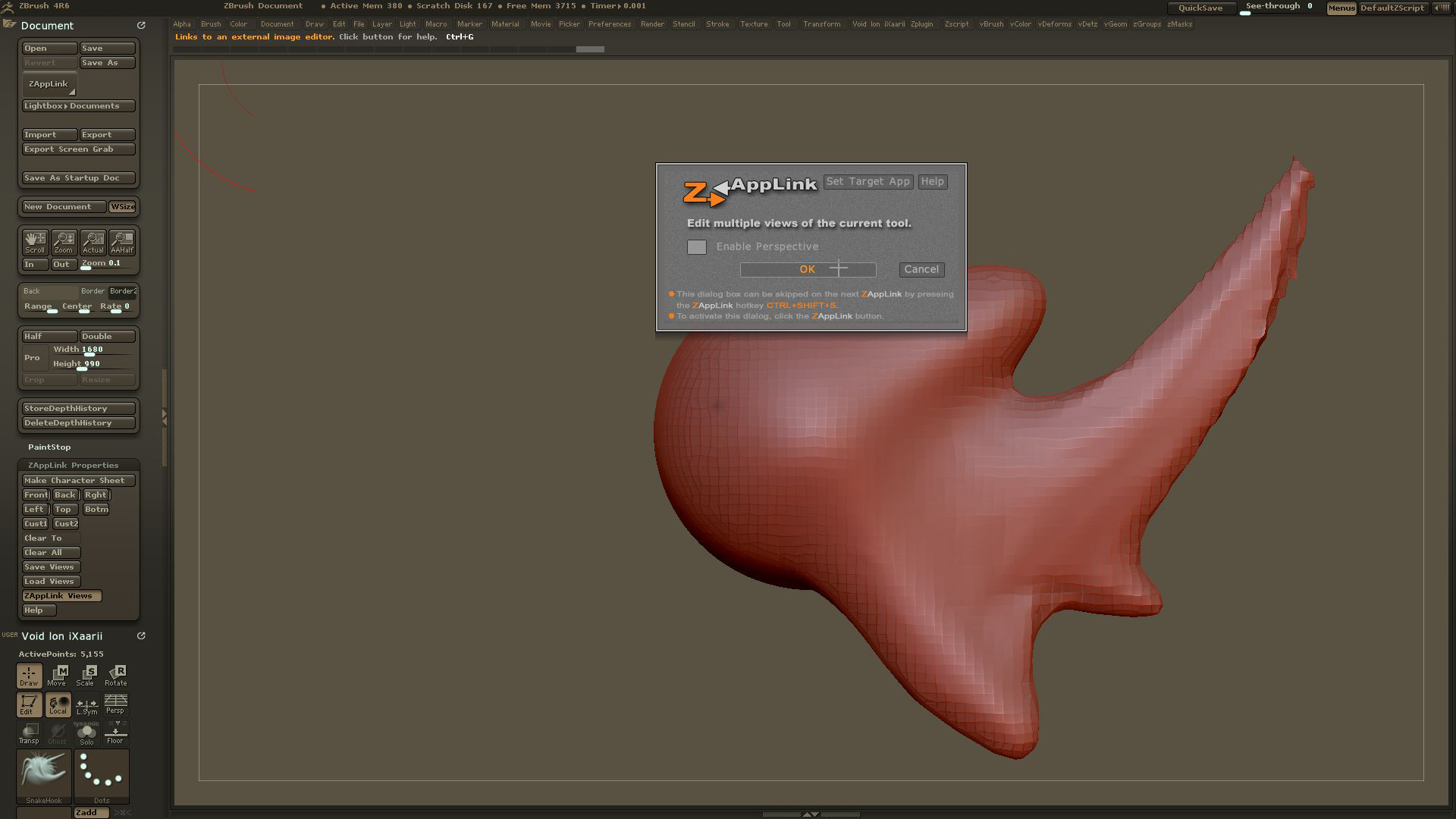

  1. zapplink normal

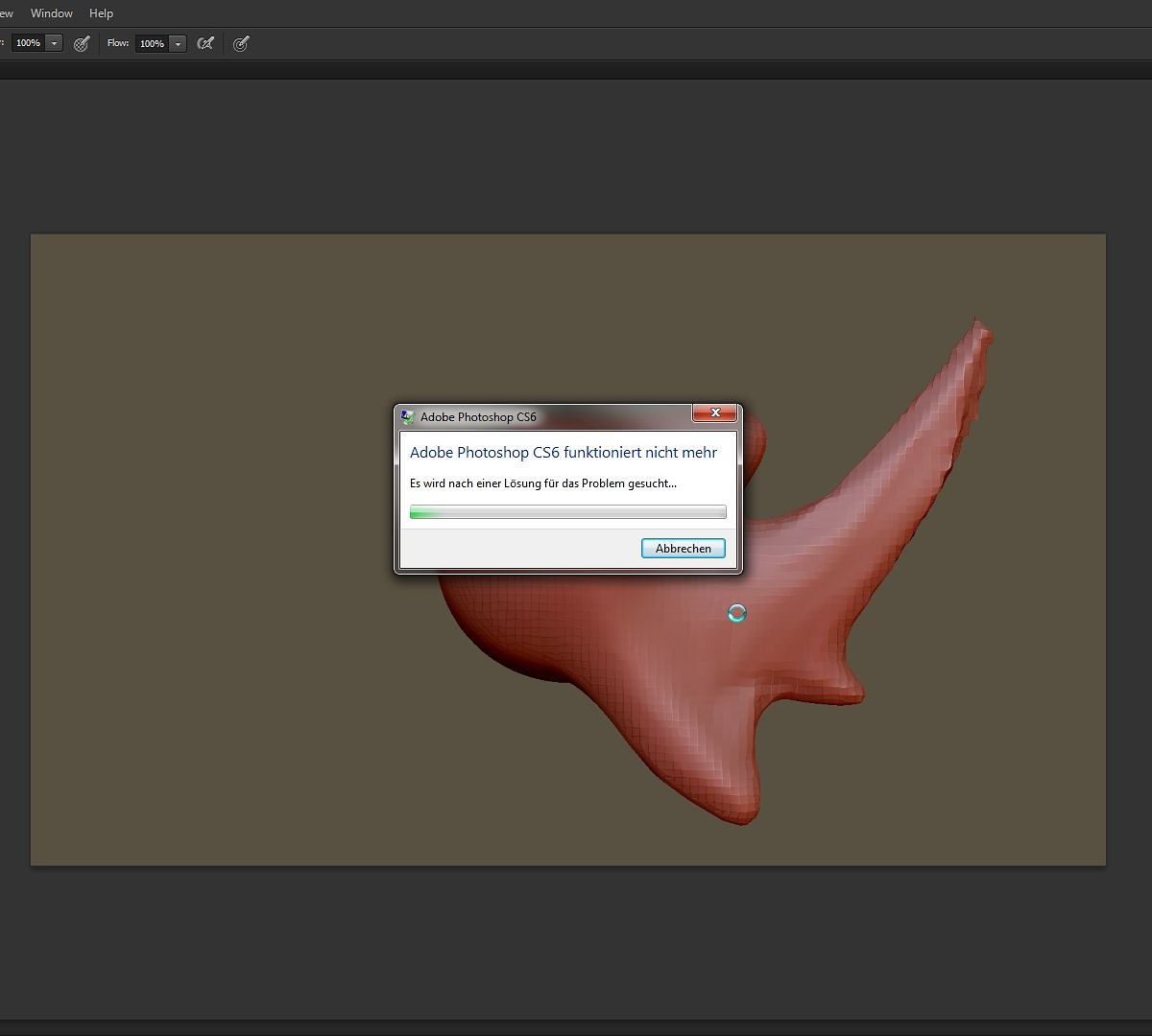

  1. error

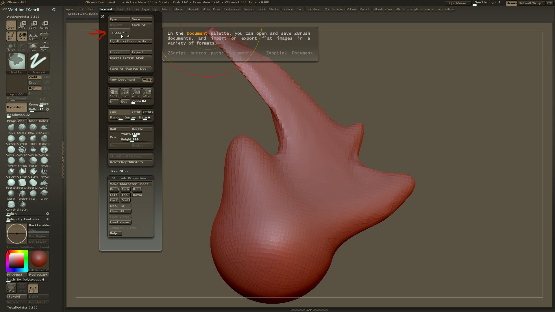

  1. set views front, side, left, right in the Zapplink properties in the Documents menu

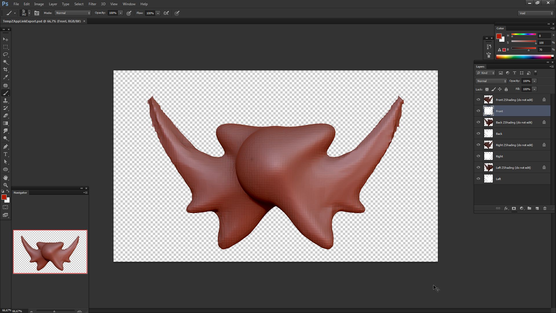

  1. zapplink multiple views now starts instead of normal one although same button
  1. works, but sends over many (undesired) layers

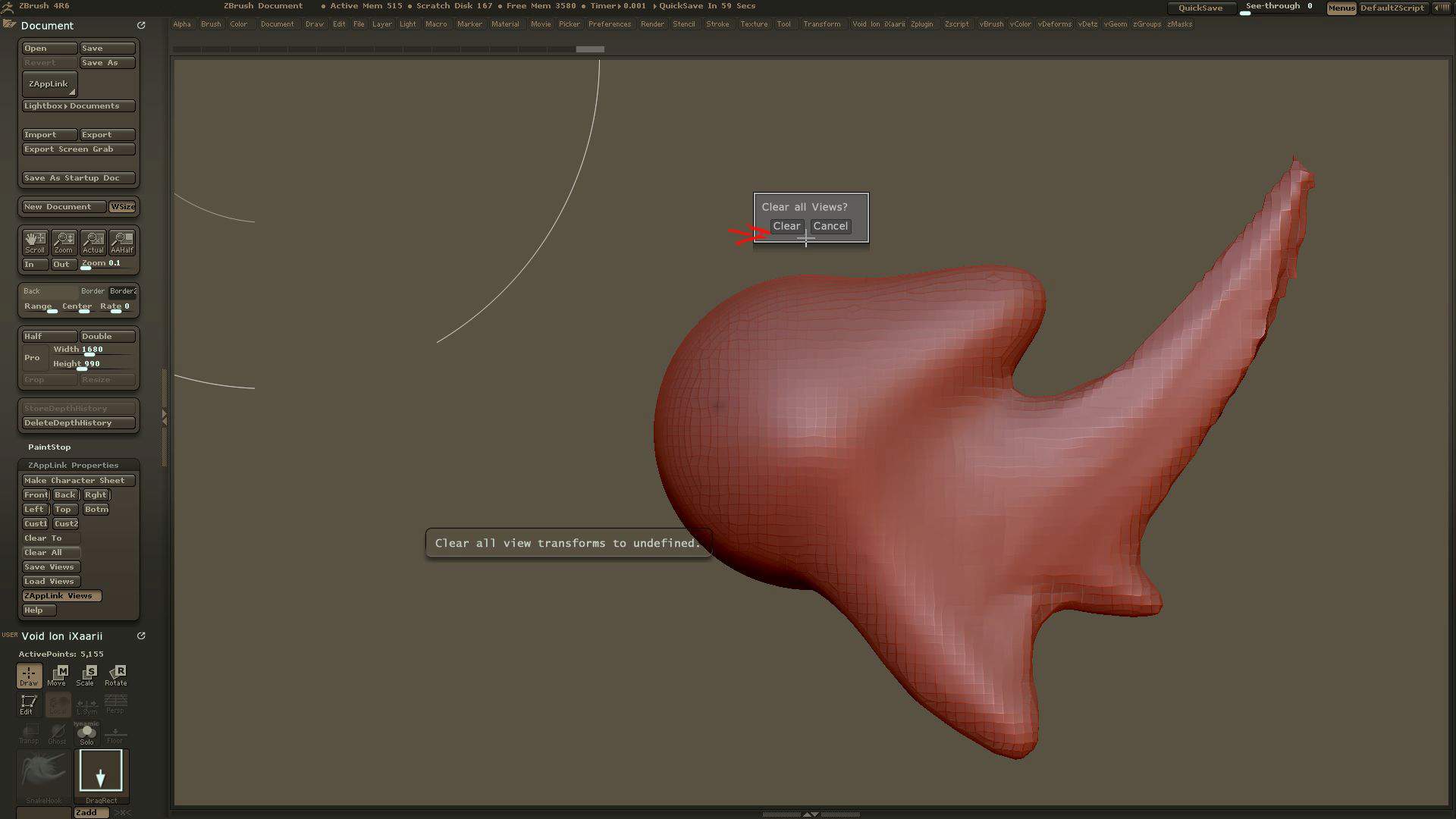

  1. but if I clear the views
  2. clear all
9) it doesn’t work again, giving the same photoshop crash

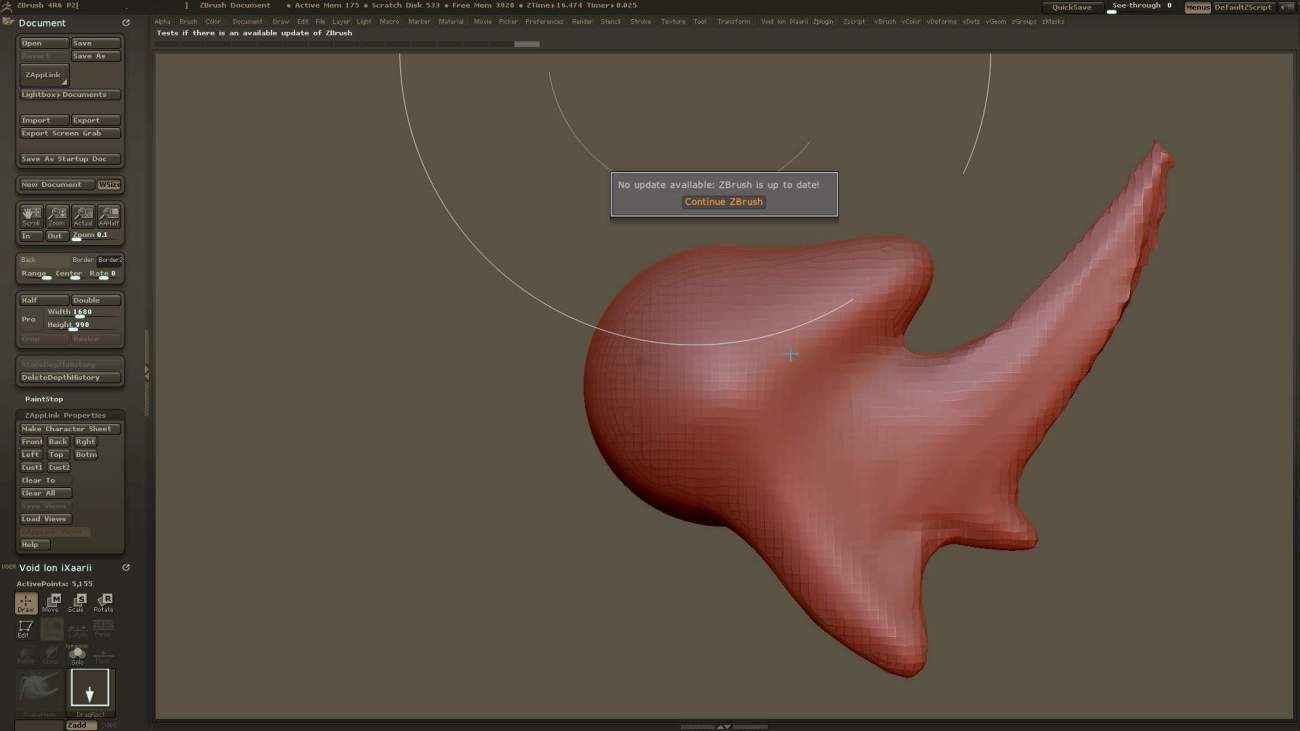

Ah, screen grab. I see you should update to ZB4R6 P2 :wink: ZPlugings:AutoUpdate
Unfortunatelly it’s not that either.
