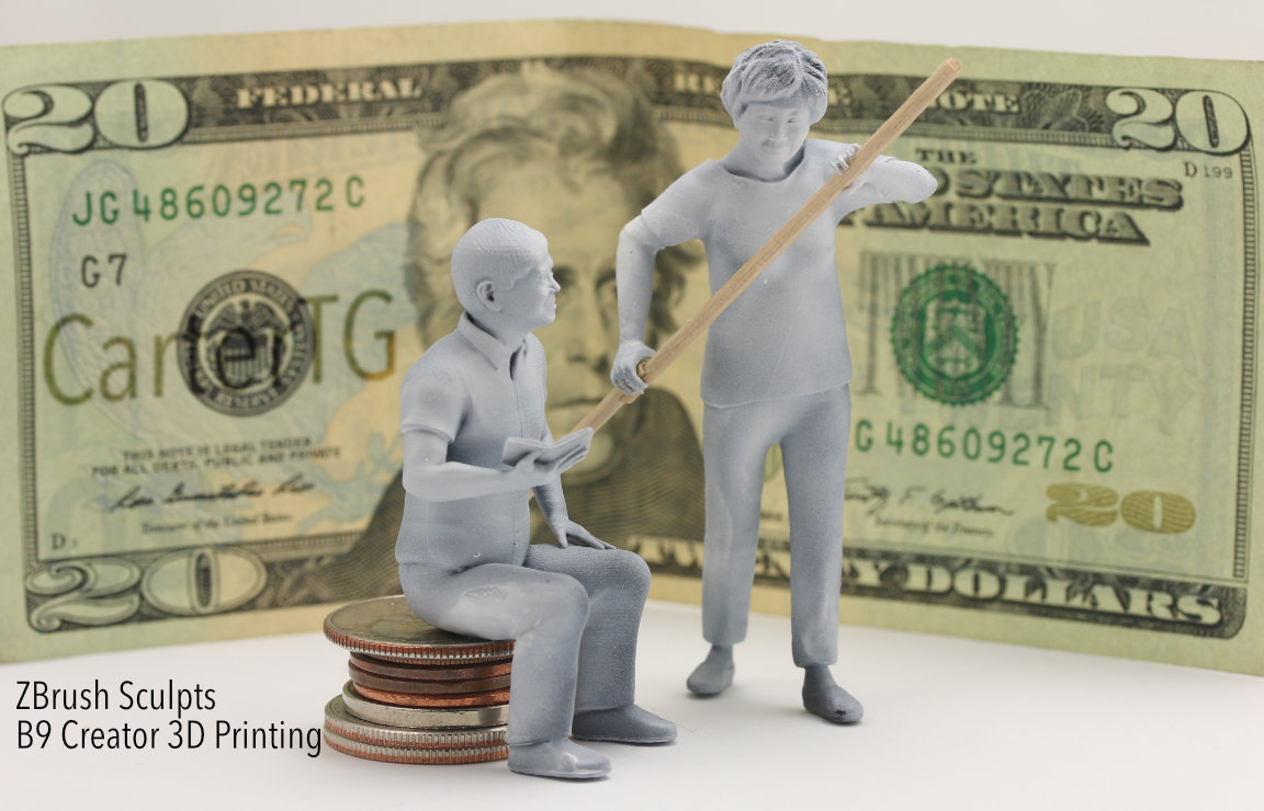

I’ve taken my 3D scans, brought them into ZBrush where the noisy, dirty mesh gets cleaned up. If there are excessive holes in the 3D mesh, the good parts can be re-projected to another surface or can merely serve as landmarking reference.
Another acquisition method is to sculpt using photo reference. The two figures below were sculpted from 3-4 reference photos each and 3D printed on one of my SLA printers at 30 microns X-Y at 25 micron (Z) slices.
During sculpting, there’s a procedural process to retopologize and control subdivision levels. This will ensure relative ease in posing the models while maintaining detail. These figures were initially sculpted in a rigid T-pose.
ZBrush’s Subtools feature can be used to keep an array of wardrobes (and arsenal) on the figure and simply flick them on as wanted. Pose the custom-suited figure and export that specific final result to an STL mesh file that most current 3D printers ingest.
