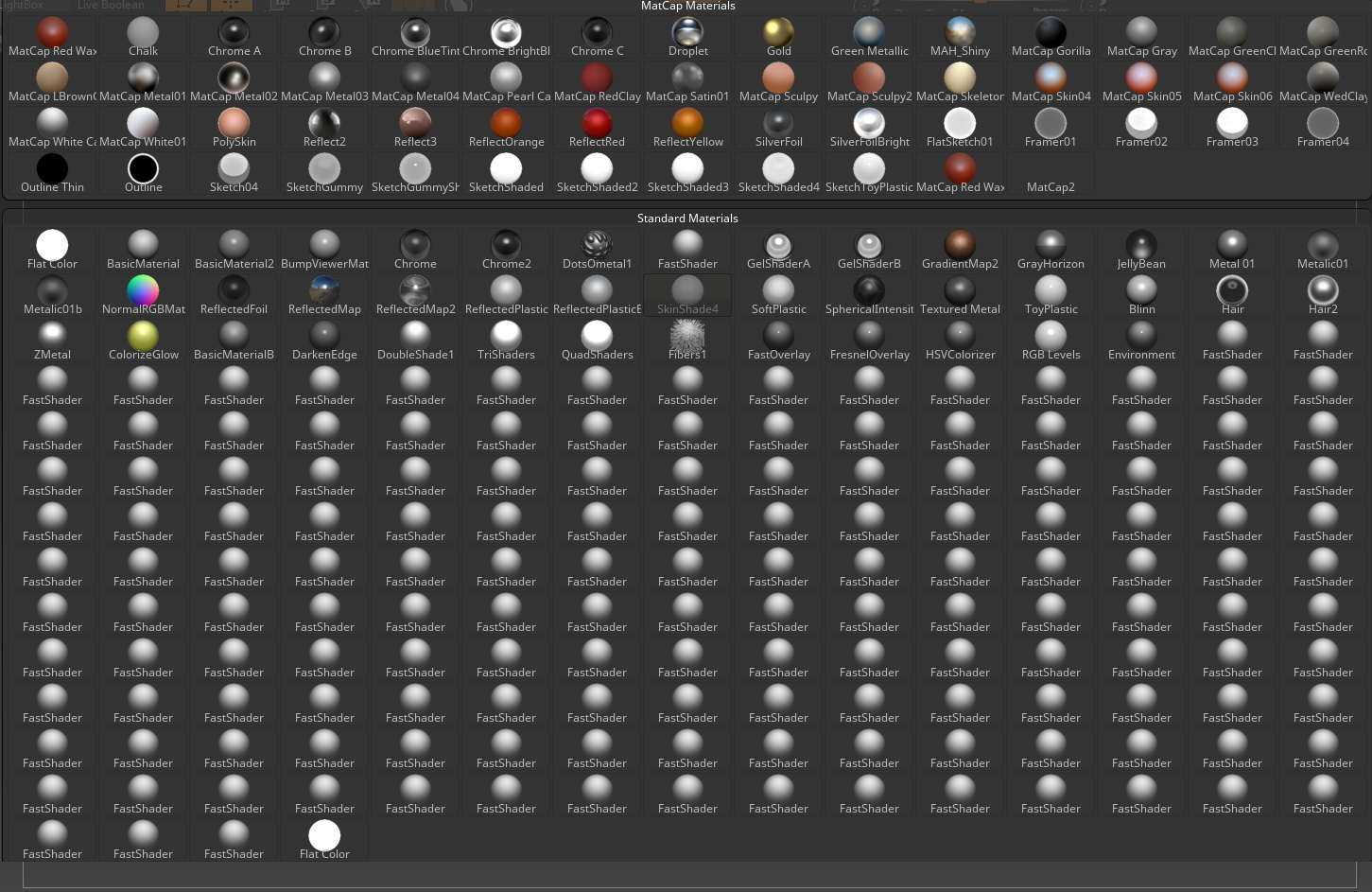

Why does a lot of FastShader appear?
Sometimes when I am using zbrush the material menu fills up with a lot of “FastShader”. Does anyone know why this is happening or how to fix it?
Thanks in advance.

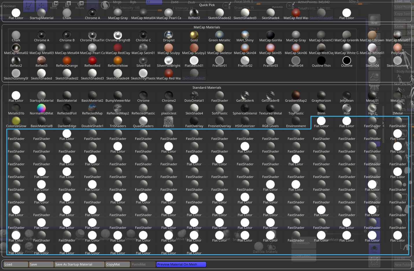

I feel like I’m taking crazy pills, I am dead tired and I put together a post that is the exact same issue. I’m getting a lot of Fast Shader and Flat Colors:
Why is this happening? It’s starting to appear on many of my models :frowning:

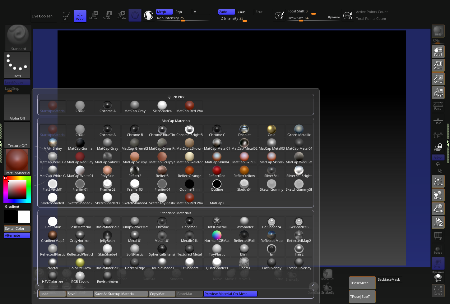

Something I notice about the screenshots from both of you, is that your material menu is larger than your canvas. Out of curiosity, what screen resolution are you running Zbrush at? The recommended is 1920 x 1080 or larger.
Yeah I’m using 1920x1080.
here’s my normal size
Hmm yeah that is weird, now that I compare the two… it’s much wider.
This picture is what it is with a clean new document and a freshly booted application.
The earlier picture is what happens after I work and save over a couple of days.

I’ve never witnessed the change happen. I just notice it when I go to look at materials after 3-4 days of working. Also, when I click “new document” after this has happened, it remains this way (prob as expected)
It may have a tie in with files I’ve done some polypainting, color-filling, layer painting on. But I’m not sure. I never ever choose fast shade material and haven’t needed to clear my object with flat color (very rarely so far) -but I haven’t used it at all on these models.
I wonder if it has to do with times I’ve rendered? Or pressing fill object in color menu?
