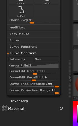

Where is the "max points" slider in ZBrush 4R6's Stroke=>Curve modifiers ?!
Where is the “max points” slider in ZBrush 4R6’s Stroke=>Curve modifiers ?!
It does appear in the documentation but i cant find it over there !
This is how it suppose to look :
http://docs.pixologic.com/reference-guide/stroke/curve-modifiers/
This is my menu :
Welcome to ZBC. :slight_smile: I have moved your question to the Other Questions and Troubleshooting Forum - the best place to ask about things.
To answer your question: the Max Points slider was removed in the 4R6 because of changes to the way curves work. You can change the number of points along a curve by changing the Draw Size of the brush. Thanks for pointing that out, I have corrected the error in the online docs.
