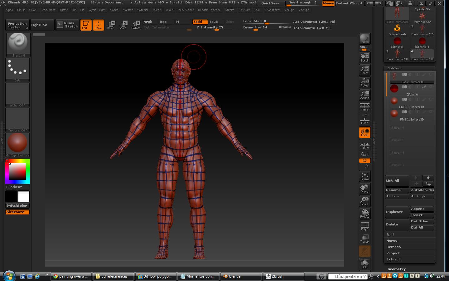

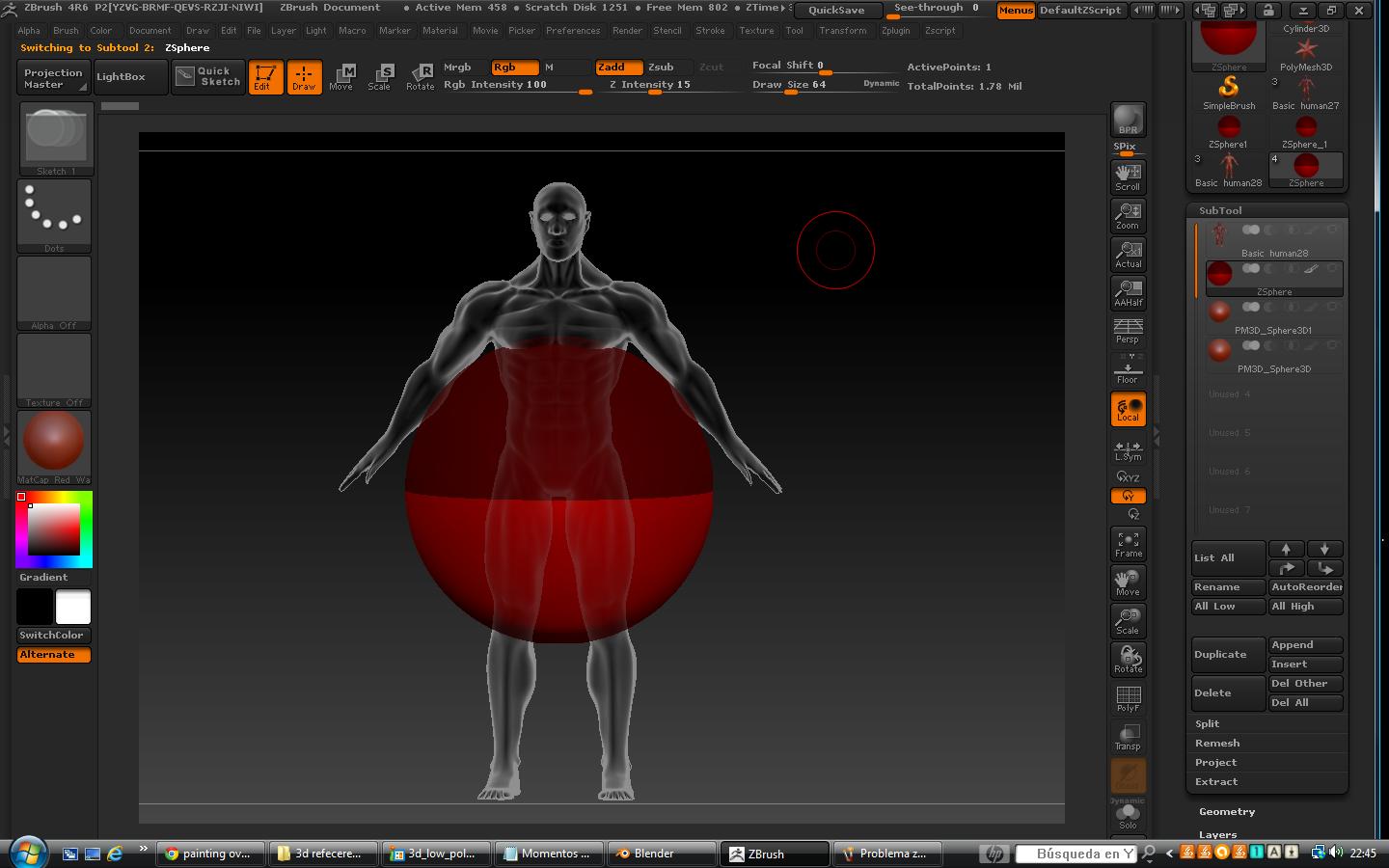

Hi, I’m trying to do a retopology using a Zsphere, but when I try it, my reference model turns negative

Its not negative so much as transparent.
Look down in the lower right, you will see transparent, ghosting and solo, try flipping them on and off…
In your case it looks like you only have ghost on, so screw with that first.
