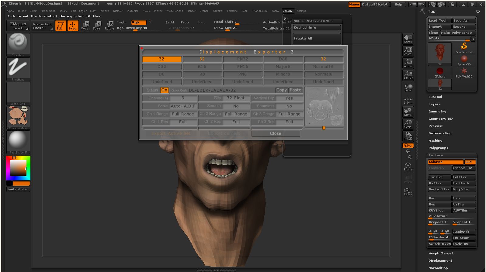

So heres the quick code I used
DE-LAGK-EAEAEA-D32

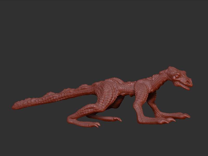

heres my original
weird lizard thing

Quick codes are used in the displacement exporter to bridge the program.
It allows you to set scale factors, color settings, bit depths and more from the displacement and normal maps.
You type them in as a preset.

I’ve just finished up with an insanely high poly thing and want to try the exporter code. You said that it was for displacement and normal maps, right?
So how/where do I plug in the code? I’ve looked under displacement and normal but don’t see it???

Dark if your using max make sure u use this q code
DE-LAGK-EAEAEA-D32
I think you had Mayas q code in there
