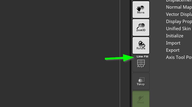

What happened to my colors?
While I am working on a model, I occasionally switch between the Polyframe view and the Dynamic Subdivision to see how it looks. Everything works great. But on occasion when I go back to the Polyframe view - I loose all of the Polyframe colors. Everything turns to a white Polyframe grid. The only way I can get the colors back is to quit/restart ZBrush and then reopen a QuickSave of the project.
What did I do to cause it and how do I get the colors back without quitting? Help!
Hi @LD1
If you look closely at the PolyF button, you will see “Line” and “Fill” at the top of the button. You probably accidentally clicked on the “Fill” toggle. Turning that on and off will turn polyframe color on and off and clicking on the “Line” toggle will turn the grid lines on and off. All you had to do was click on “Fill” to turn the color back on.
2024-03-10 15_51_59-ZBrush
That did it! Thank you for your help.
