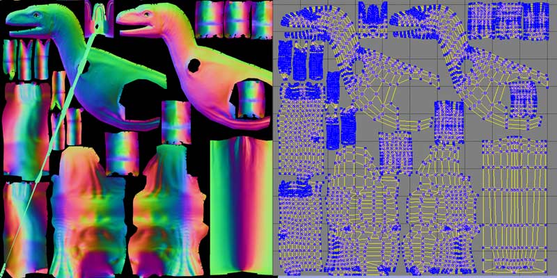

As you can see from the attachment I have a weird UV ‘streaking’ problem suggesting a UV overlap. You can see from the UV grab on the right that the UV is good, so whay am I getting this problem in ZBrush?
Doing a UV check in Z brush suggests an overlap here too so why is there a problem here and not on the original UV?

Since posting I have found that it is indeed a problem with Z Brush.
For some reason it takes a ponit on the UV and throws it back to its ‘0’ coordinates.
The work around is to store the morph target at sub d 1, import the model again and switch morph targets with restores the dodgy UV point. Crazy…

this little funky result append to me sometimes ( looks familiar )
the reason its becouze you have probably one or few vertex spread out
in the hige level of your model .
for my opinion go to your top level in the model
and check carefully if you can see point spread out
if yes you must to take them back to the original geometry .
after you change ( if you find some ) you must to go back
to your original software and change again the position of the uv/s
that snap to the coordinate
hope it help :wink:
