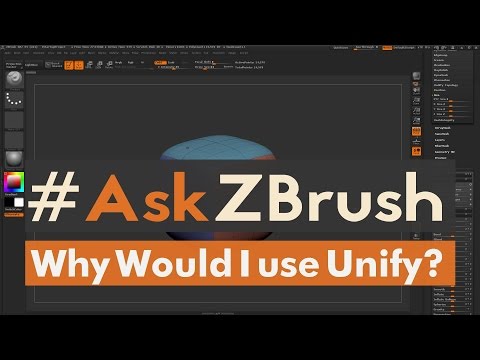

I’d wonder if your model is problematically sized or drastically offset from center in the worldspace. Issues with brush sizing are frequently linked to oversized models. Indeed, if you’re finding that it’s difficult to get the correct sizing with Dynamic mode, this is often caused by working with too large of a model. The following video specifically warns about brush size issues with oversized models:
In the case of drastically oversized models, or models that have a drastic offset from center in your original, imported file, you can run into weird issues with the brush cursor changing, especially with areas that are recessed or near major overhangs.
A simple test for this is to use Tool> Deformation> Unify on the mesh and see if the issue goes away. If it does, then this was your problem.
