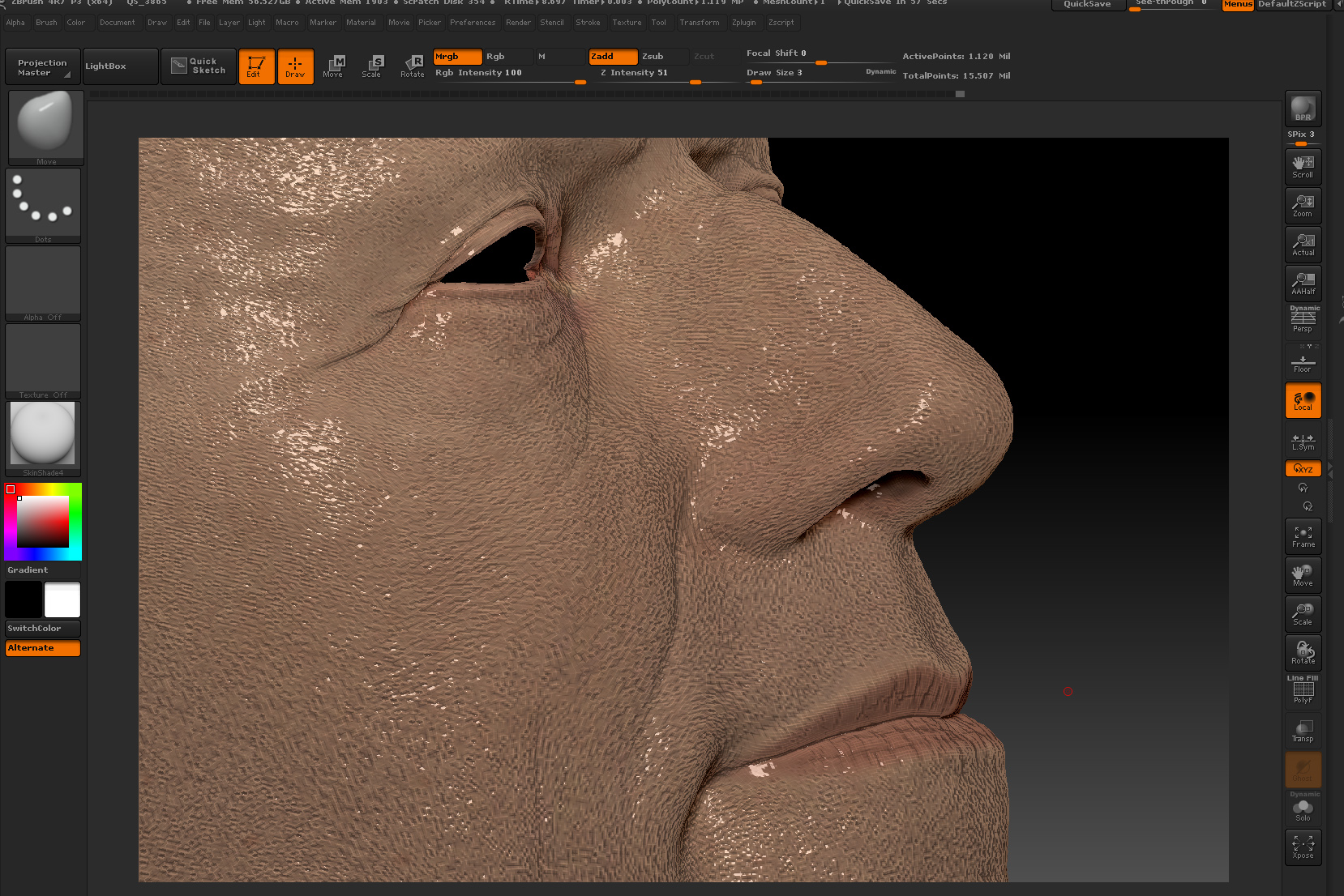

Has this happened to anyone else - high gloss and weird cavity texture when I was expecting SkinShader4? I can’t find a way to fix this. Any help greatly appreciated.
Your image says “4R7 P3”. :wink:
Thanks for replying. Yes, it is R7, but the R8 version displays the same. Thinking that there was something wrong with my R8 install I went back to R7, but my original file seems to have been changed by exposure to R8!
Do you have any idea what might be happening and how I can fix it? Thanks.
You’ve just got a material embedded in the model. You presumably did it by accident. Do this:
  1. Switch on the ‘M’ button in the Draw palette (or just to the left of Zadd at the top of the UI). This will mean you are only using Material.
  2. Select the Flat Color material.
  3. Press Color>Fill Object.
This will fill your model with the Flat Color material which effectively removes any embedded materials. You can now switch back to the SkinShader4 material and it should display correctly.
Thanks Marcus, that has fixed it. Up and running again!
